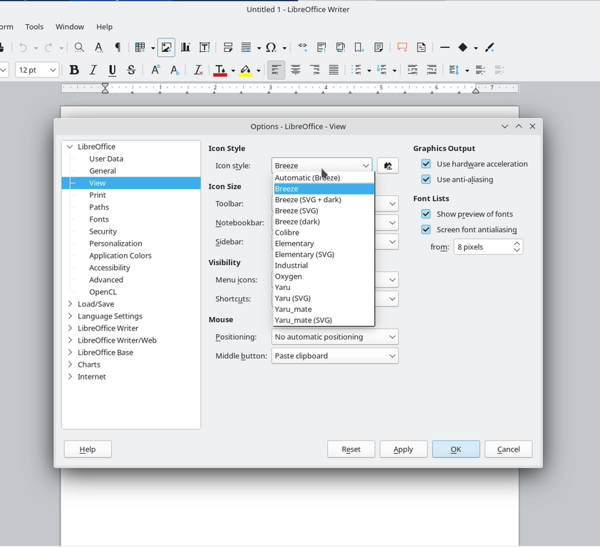

    With Libreoffice, you have to set some of the theming from within the application's settings manually, as it doesn't seem to like following any desktop settings for this very well. This isn't due to it being Flatpak, but due to Libreoffice doing its own thing. Usually, you need to go to Tools >> options >> view and adjust the icon set to better match the color scheme. You can also install LO extensions th at might work https://extensions.libreoffice.org/e...-color-palette

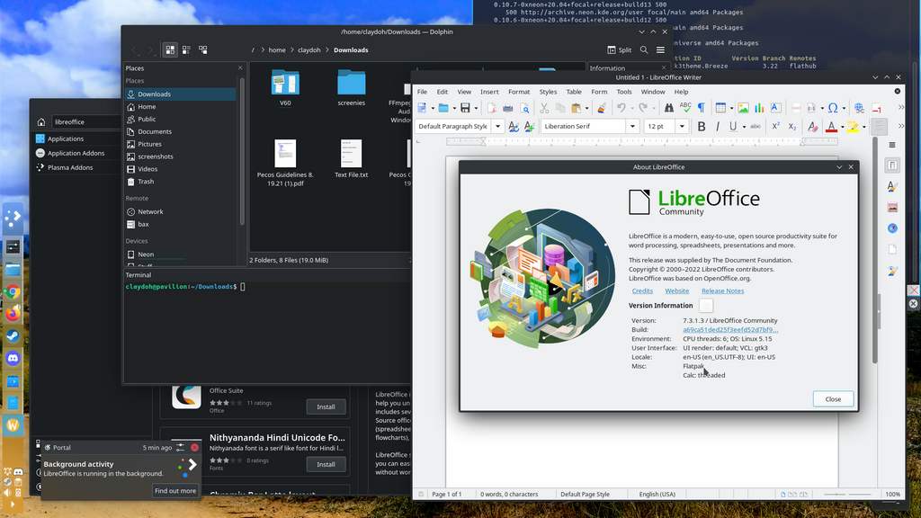

        Oddly using Flatpak version here, I can't reproduce this, though I did need to change icon theme, as expected.
          Here is mine:Click image for larger version
