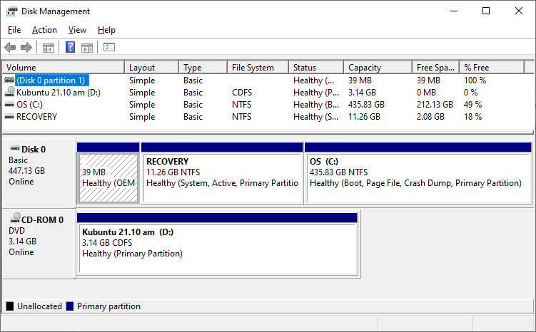

        Thumbnail attached. No sign of Linux partitions on the drive. As I mentioned, I recall the installer saying it would run like any other application, not as a true dual boot system.

              Based on the OPs screenshot, Kubuntu isn't installed 'alongside' Windows. It's inside Windows, on Windows Drive D: Note the File System of CDFS.
                That is likely just the ISO image being auto-mounted, not installed --see the size matching the size of the ISO. I have no idea how Windows might be doing this automatically, or how to stop it, but Windows definitely can mount ISO images natively, at least manually.
                    But notice that in the screenshot provided, there is NOTHING Kubuntu except for the drive D:. Kubuntu isn't installed IMO; it's being mounted from the D: drive and run 'live'? It isn't installed.

                          As Drive D: only has the Kubuntu ISO on/in it, you could simply delete the drive D: partition.
                          See https://www.windowscentral.com/how-d...ion-windows-10 and scroll down to Delete partition with an assigned drive letter
                          Slava Ukraini! πŸ‡ΊπŸ‡¦
                            D is not recognized as a partition. It's a standalone virtual drive linked to the ISO. If I eject the disk, it automatically remounts. Don't know what program is doing the mounting, it was setup during the installation.
