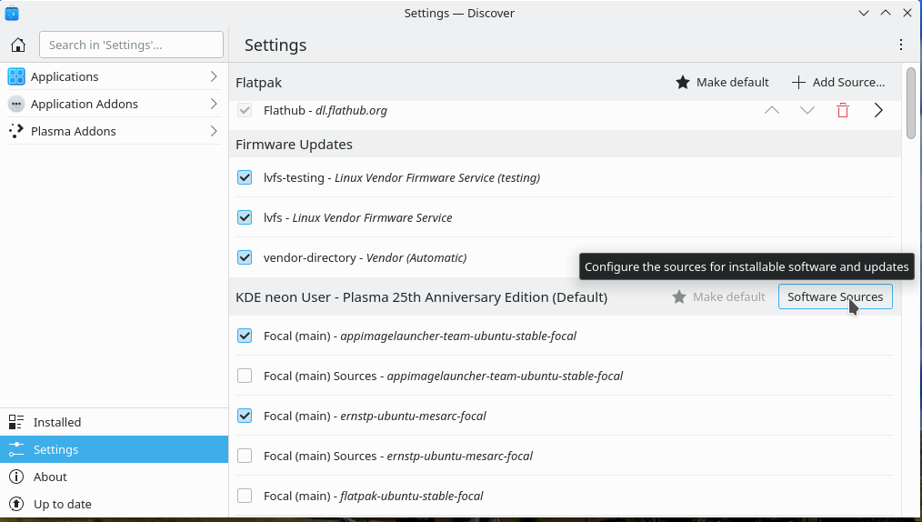

    The Software Sources tool will be software-properties-qt, as it is now shared with Lubuntu. It hides in Discover's settings area, under Software Sources.

          Software Sources be accessed from Muon or Synaptic - which are already running with sudo. It can also be accessed from Discover.
          Standalone, you would need to specify more environmental variables with pkexec:
          pkexec env DISPLAY=$DISPLAY XAUTHORITY=$XAUTHORITY  software-properties-qt
          This is probably how Discover's button is calling it
