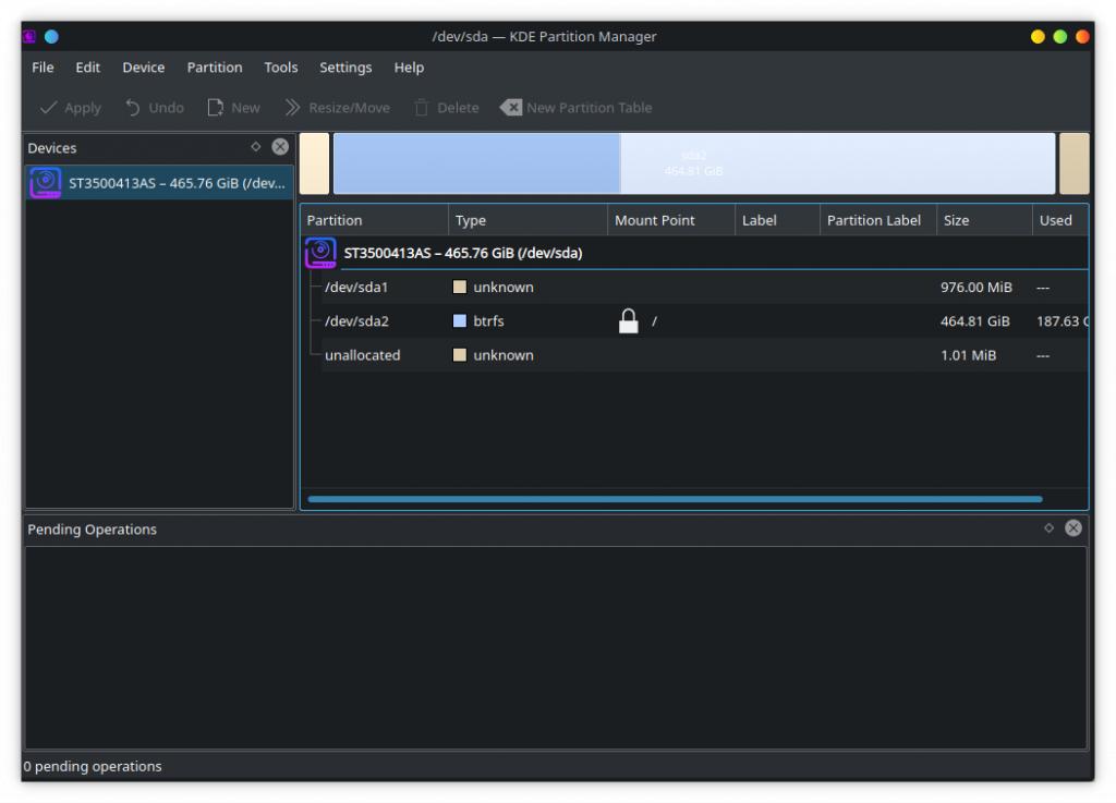

                  I'd like to know your final storage configuration, and where grub lives.
                  I'm not sure if this is relevant to you, but it might be. If one manipulates btrfs subvolumes that are used by grub or mounted by an install, there's two places that need attention: /etc/fstab, and the grub configuration.
                    According to KDE partition manager, grub lies in sda1, 976 MB in length. Actually, it says 'unknown', but that's where I set the bootloader, so I guess Grub's there. BTRFS is on the rest of the desk, and is marked sda2. Did I answer your question?

                      Originally posted by oldgeek View Post
                      What I think MIGHT have happened is that when I had done copying I forgot to change the settings back to read-write. Could that have kept me from going past the login? I would appreciate any thoughts on this so I can anticipate potential problems when 21.10 comes out. Thanks for the help.
                      Yes, I believe that could be what kept you from logging in after the first successful installation. Either that, or some conflicting settings somewhere around your hidden files in your home folder, which would explain why you were able to login in recovery mode. Or even, you mentioned you were changing the name of some folder... What folder exactly? Your user's home folder has to be named exactly as the username you're using to login.
