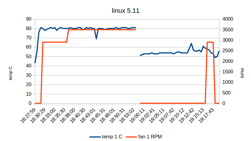

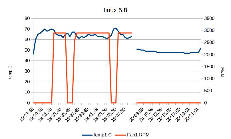

                I tried to log sensor data and put them on a chart. The test is quite rudimentary (if somebody could tell me how to do a better one, i'll try to do it): running wine, than playing some full-screen YouTube videos. The results were as previously, using kernel 5.11 gave me higher temperatures than kernel 5.8. I know it's not that much of a difference, but i find it somewhat bothering, and i'm curious if it can be fixed.
ID:	645165Click image for larger version
