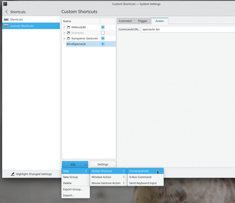

          $ spectacle --help will reveal the command option(s) to use with your custom keyboard shortcut to do many things.
          Thanks, "-bn" seems to work--but where do I put it?! In KMenu, Spectacle's "command" entry is this: qdbus org.kde.Spectacle / StartAgent -- I've never even seen a command like that.
          Replacing that with spectacle -bn does cause a screenshot to be taken without displaying anything--but only if I run it from the menu, not if I press one of its shortcut keys. I know I'm just not connecting some dots right now...
            Create a new custom shortcut.

              Use a custom keystroke, like ctrl-printscreen, etc under the 'trigger' section. Something separate from the standard screenshot shortcut.
              Your settings area *may* look slightly different (if at all), but the process and steps should be the same.

                I'm blowing a big fat kiss your way, @claydoh!!
                I appreciate the visuals, but your original comment was all I needed to connect the dots--the ones I knew I was missing.
                Since I want to keep [F1] as my shortcut, that's what I assigned to this. If I ever need Spectacle to behave its natural way, I'll just hit [print screen] instead.
