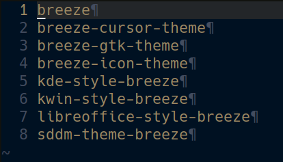

        First, I run
        COLUMNS=200 dpkg -l | grep breeze | tr -s ' ' | cut -d ' ' -f 2 > ~/Desktop/breeze.txt
        I open ~/Desktop/breeze.txt in vim. Each line ends with a pilcrow (?) and there's no space immediately before the pilcrow as seen in the image:

        Now, I run
        PCKGS=$(COLUMNS=200 dpkg -l | grep "^rc" | tr -s ' ' | cut -d ' ' -f 2)
        and follow that with
        echo ${PCKGS}
        which gives me:
        breeze breeze-cursor-theme breeze-gtk-theme breeze-icon-theme kde-style-breeze kwin-style-breeze libreoffice-style-breeze sddm-theme-breeze
        The question: how do spaces appear between the package names? What does "echo ${PCKGS}" do to convert the "one package name per line" (as seen in the image) to the single line output with package names separated by spaces?

          If you wish to preserve control chars, you'd put the variable in double quotes, otherwise they are replaced by spaces.
          echo "${PCKGS}" vs. echo ${PCKGS}

              Taking that question mark as implying a question, your .vimrc (or some other rc file) includes something like
              set nu list lcs=eol:?
              to make visible the line numbers and the ends of lines.

                I have
                set list listchars=tab:→\ ,nbsp:␣,eol:?
                in my .vimrc. My sticking the "?" in the earlier post was because I wasn't sure whether the ? was an end-of-line or carriage return or "\n". I'm don't know how/whether those differ and are to be termed.
