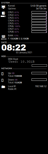

                    Here's what I've been running for the past couple years, I'd welcome an update to current syntax if anyone has the time and interest.

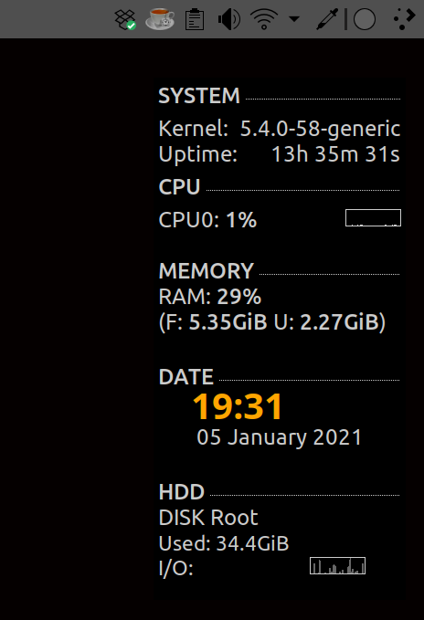

                      I looked at your conky and couldn't follow the network section (and so I dropped that). But the rest, simplified a bit and without the images, would look something like this in the new format:
                      conky.config = {
                      update_interval = 1,
                      total_run_times = 0,
                      net_avg_samples = 1,
                      cpu_avg_samples = 1,
                      if_up_strictness = link,
                      double_buffer = true,
                      no_buffers = true,
                      format_human_readable = true,
                      use_xft = true,
                      font = 'Ubuntu:size=18',
                      override_utf8_locale = true,
                      text_buffer_size = 2048,
                      own_window = true,
                      --own_window_class = 'conky',
                      own_window_argb_visual = true,
                      own_window_transparent = true,
                      own_window_hints = undecorated,below,sticky,skip_taskbar,skip_pager,
                      own_window_type = 'override',
                      alignment = 'top_right',
                      gap_x = 25,
                      gap_y = 90,
                      --minimum_size 182 600
                      --maximum_width 182
                      --default_bar_size = 60 8,
                      draw_shades = false,
                      default_color = 'cccccc'
                      conky.text = [[
                      ${font Ubuntu:style=Bold:size=18}SYSTEM $stippled_hr${font}
                      ${voffset 8}Kernel:  ${alignr}${kernel}
                      Uptime: ${alignr}${uptime}
                      ${voffset 8}${font Ubuntu:style=Bold:size=18}CPU $stippled_hr${font}
                      ${voffset 8}CPU0: ${font Ubuntu:style=Bold:size=18}${cpu cpu0}%${font} ${alignr}${cpugraph cpu0 18,60 ffffff}
                      ${font Ubuntu:style=Bold:size=18}MEMORY $stippled_hr${font}
                      RAM: ${font Ubuntu:style=Bold:size=18}$memperc%${font}
                      (F: ${font Ubuntu:style=Bold:size=18}${memeasyfree}${font} U: ${font Ubuntu:style=Bold:size=18}${mem}${font})
                      ${voffset 4}${font Ubuntu:style=Bold:size=18}DATE $stippled_hr${font}
                      ${voffset -10}${alignc 46}${color orange}${font Noto:style=Bold:size=30}${time %H:%M}${font}${color}
                      ${alignc}${time %d %B %Y}
                      ${voffset 4}${font Ubuntu:style=Bold:size=18}HDD $stippled_hr${font}
                      ${font Ubuntu:style=normal:size=18}DISK Root
                      ${font Ubuntu:style=normal:size=17}Used: ${fs_used /}
                      I/O: ${offset 122}${diskiograph 18,60 666666 666666}
                      I had to play around with "own_window_type". That bit's always been dodgy for me.
                      BTW, "cpugraph" or "cpubar" will remain mostly 100% empty unless something very CPU-intensive is in progress. And having each core with its empty graph didn't seem too useful so I went with cpu0.
                      The image below shows the part of your conkyrc I "converted":
                      Kubuntu 20.04
                        I run BOINC tasks -- Milkyway on CPU and Einstein on GPU -- so seeing the CPU graphs is helpful as an early warning that something isn't right (empty means Milkyway has stopped for some reason -- as it should when certain other programs are running -- and full means it hasn't stopped as it should when playing a game or in browser). I can probably fix that part.
