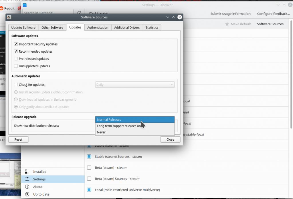

    I tried to follow this guide: https://help.ubuntu.com/community/Gr...grades/Kubuntu
    At one point it asked me to "Switch your upgrade settings from LTS only to 'normal'."
    I can't find an option to do this meaning that I am now stuck.
    Please help me ASAP!

    LTS releases only have upgrade notification set for the next LTS, so to upgrade to 20.10 you need to change a setting in the Software Sources tool.
    The easiest way to find this may be to search for the term 'software' or 'software sources' in the k-menu. Otherwise, it will be found in the Settings section in Discover. There will be a tab for updates, and you can change the upgrade options away from 'LTS Only' to 'normal releases'
      From the setting page of Discover, press the 'Software Sources' button top right. On the updates tab of the software properties application select 'Normal Releases' in the drop down box for 'Release Upgrades', and exit.

        I didn't see the post until now because I got no notification. I will try now!
        Edit: I have just changed to all updates. Is there any way that I can make it check for updates without waiting until tomorrow? If not I can wait.

          You can start the upgrade tool manually
            Thank you so much! It's updating now. Will update if anything goes wrong.
