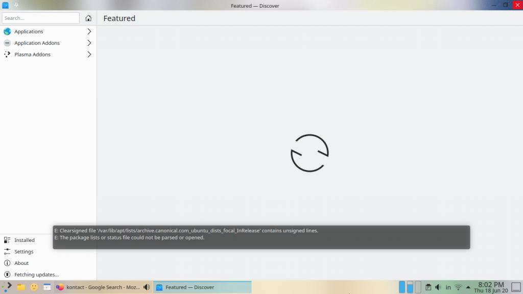

    Discover store is not able to connect to the internet ( I think ) and shows some error. I took a screenshot. Please help me fix it

    Weird, I can't help much, here Discover is on the network but it is a disaster by design.
    Does apt work from the Konsole?
    Install and use Muon, much better.

      What third-party PPAs/Repositories do you have? Open a konsole and type: ls -la /etc/apt/sources.list.d
      Copy and paste the output here.

        Thanks. Please see
        $ ls -la /etc/apt/sources.list.d
        total 24
        drwxr-xr-x 2 root root 4096 May 12 00:28 .
        drwxr-xr-x 7 root root 4096 May 12 00:41 ..
        -rw-r--r-- 1 root root 189 May 12 00:40 google-chrome.list
        -rw-r--r-- 1 root root 189 May 12 00:40 google-chrome.list.save
        -rw-r--r-- 1 root root 140 May 12 00:40 inkscape_dev-ubuntu-stable-focal.list
        -rw-r--r-- 1 root root 140 May 12 00:40 inkscape_dev-ubuntu-stable-focal.list.save
        -rw-r--r-- 1 root root 0 Apr 24 17:13 papirus-ubuntu-papirus-focal.list
        -rw-r--r-- 1 root root 0 Apr 24 17:13 papirus-ubuntu-papirus-focal.list.save

                  I simply love the way we can select apps from a software store. That is why I would like to bring Discover back.
                    Well, the idea was to try and find out what the problem with Discover was.
                    If apt works, it's not with the apt part of it. Does it work? Even just updating the database?

                      Here is the output of sudo apt update
                      Get:1 http://in.archive.ubuntu.com/ubuntu focal InRelease [265 kB]
                      Get:2 http://dl.google.com/linux/chrome/deb stable InRelease [1,811 B]
                      Get:3 http://ppa.launchpad.net/inkscape.dev/stable/ubuntu focal InRelease [17.5 kB]
                      Get:4 http://security.ubuntu.com/ubuntu focal-security InRelease [107 kB]
                      Get:5 http://in.archive.ubuntu.com/ubuntu focal-updates InRelease [107 kB]
                      Hit:6 http://archive.canonical.com/ubuntu focal InRelease
                      Get:7 http://in.archive.ubuntu.com/ubuntu focal-backports InRelease [98.3 kB]
                      Get:8 http://dl.google.com/linux/chrome/deb stable/main amd64 Packages [1,127 B]
                      E: Repository 'http://ppa.launchpad.net/inkscape.dev/stable/ubuntu focal InRelease' changed its 'Suite' value from 'focal-updates' to 'focal-security'
                      N: This must be accepted explicitly before updates for this repository can be applied. See apt-secure(8) manpage for details.
                      Do you want to accept these changes and continue updating from this repository? [y/N]
                        Well, either say yes or no to the inskcape repo (no reason to say no, IMO), and see if it does update the database... the name change could actually be what blings Discover...
                          If that PPA is important to you, then answer "y" and press on. Otherwise, remove that PPA, and press on.

                              looking at the error message in the OPs first post, it looks like the Partner repo is causing the issue, probably not a PPA.
                              This extra repo doesn't have anything useful for most (if anything at all for Focal) and is not enabled by default.
                              Anyway:
                              In Discover, go to Settings , then look for Software Sources, and go to the Other Software tab, and make sure to un-check the Canonical Partner repo

                              The error message is likely temporary, there may have been an issue with that particular server, or perhaps a corrupted file download , so once you have updated etc you can try and re-enable it if you need something from it, and see if it has been fixed.
