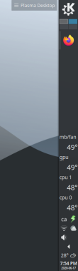

              Perfectly right Don! But sometimes need to move on. Here is the Thermal Monitor widget I used up to 18.04. Being on the taskbar is always visible (except for full-screen). In Kubuntu 20.04 I have to reload temperature sources after each reboot (they are set, but do not reload automatically).

              On Neon, still 18.04, but with the latest Plasma, this widget installs, but its setting window brakes Plasma. Replaced it with Simple Monitor widget which is a desktop only widget, and have the temperature, but need to switch desktops in pager to see it (although is covered by the active window).
