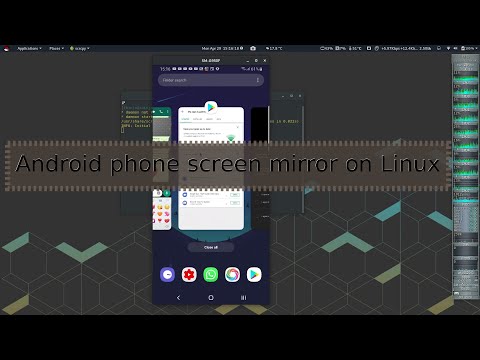

Want to see your Android phone on your PC?
    https://github.com/Genymobile/scrcpy/
    sudo apt scrcpy
    Pug a USB cable into your Android phone and then plug the cable into a USB port on your Kubuntu 20.04 laptop. (Don't know if it works with previous releases... probably does).
    After setting ABD permission and setting permissions, immediately your Android phone display appears on your laptop display, and is about the same size. However, you can expand it. When YouTube, for example, shows better in the horizontal mode it will switch or you can rotate it to horizontal.
    I found I could control my phone from my laptop using my mouse.
    Neat!

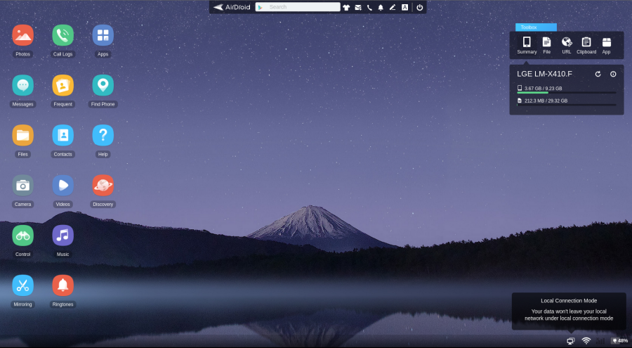

              But I can't view it with Airdoid either.
              What I see with it is this:
              which is just a mock-up of a phone screen.

                  Don B. Cilly you have to tap the Mirroring icon (scissors) to see the phone screen with AirDroid
                    Cool. I can see it, but can't act (mouse does nothing), Where's the trick to that, then
                      You are right! I had a bluetooth mouse on my android tv.
