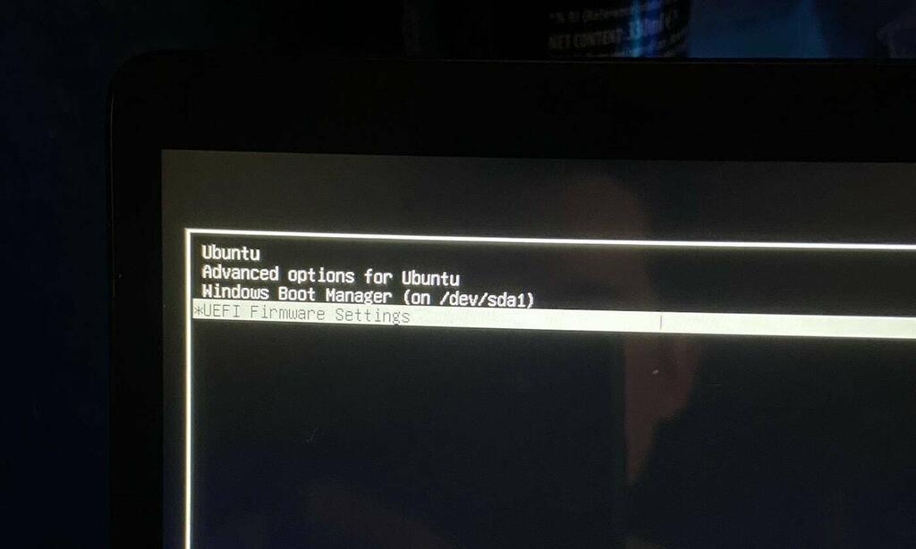

        Try selecting a previous kernel in grub when booting.
        There have been some reports of a recent kernel update causing issues in *buntu, but I think this was mainly Jammy users. However, Focal is currently using the same kernel version so it is worth checking out.
          Hello claydoh and thank you. How do I get into grub and select a previous kernel? I know I have at least the 5.4.0-121 available. I tried to flash the bios using the M-Flash utility in the bios for my MSI mobo, but it does not work. I have to figure that out too. My current bios is from 2020 and the new version was just released in July.
            In the grub menu where you can select other OS to boot, among other options. The "Advanced" section.
            Click image for larger version  Name:	grub-boot-menu.jpg Views:	0 Size:	33.9 KB ID:	664553
            You should have kernel 5.15 versions, as well as 5.4, and possibly 5.13.
            if you are not seeing this menu, try stabbing the Esc key just past your computer's POST screen
