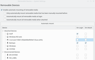

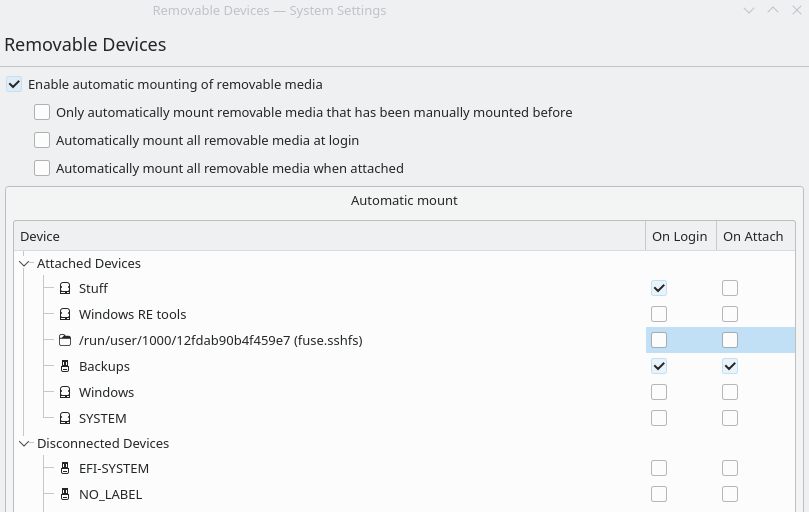

      I cheat, and configure automounting of drives via System Settings Removable Storage options. This is also accessible from the systray applet.
      Seems oddball, but it seems to work when oddball things are being mounted.

        Thanks claydoh, I follow your advice and it works fine.
        Thanks!
