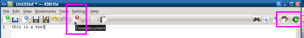

    Two years ago I posted a thread about this, but since the problem still exists in 20.04, I thought I'd try asking again.
    When I configure KWrite's toolbars, the way my choices *look* in settings do not match where they appear on the actual toolbar. Please look at these screenshots.
    Note where the 'close' button is--I've highlighted where I want it to be, i.e., to the right of the green 'refresh' button:

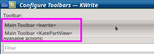

    When you access KWrite's toolbar settings, there are two separate entries:
    Click image for larger version  Name:	KWrite_two_toolbars.png Views:	0 Size:	26.5 KB ID:	659115

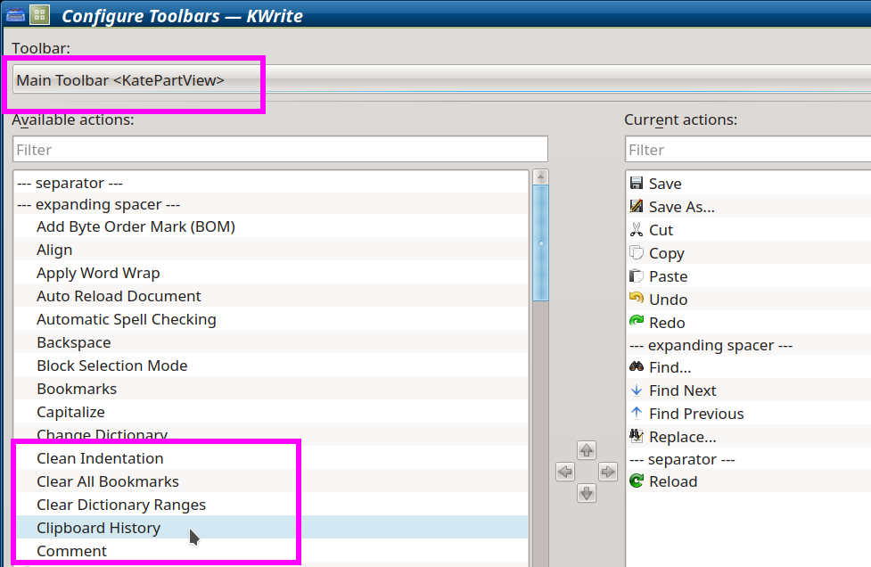

    It is not available in the KatePartView entry:
    Click image for larger version  Name:	KWrite_KPartView_toolbar.png Views:	0 Size:	109.4 KB ID:	659118

        If it can be done, I'm sure it's here in these files, but after a couple of failed attempts, I thought I'd ask for help!
          Here would be my suggestions (just the Toolbar sections of each file for clarity):
          kwriteui.rc
          <ToolBar noMerge="1" name="mainToolBar" alreadyVisited="1">
             <text translationDomain="kwrite">Main Toolbar</text>
             <Action name="file_new"/>
             <Action name="file_open"/>
             <Action name="file_open_recent"/>
             <DefineGroup name="file_operations"/>
             <DefineGroup name="print_merge"/>
             <DefineGroup name="edit_operations"/>
             <DefineGroup name="find_operations"/>
             <DefineGroup name="zoom_operations"/>
             <Separator name="separator_0"/>
             <Action name="file_close"/>
          </ToolBar>
          (moving action "file_close" after all groups, this shouldn't be strictly necessary in your case as you don't have "zoom_operations" group actions in your katepart toolbar, but doesn't hurt...where to place the separator is your choice)
          katepart5ui.rc
          <ToolBar noMerge="1" name="mainToolBar">
             <text translationDomain="ktexteditor5">Main Toolbar</text>
             <Action name="file_save" group="file_operations"/>
             <Action name="file_save_as" group="file_operations"/>
             <Action name="edit_undo" group="edit_operations"/>
             <Action name="edit_redo" group="edit_operations"/>
             <Separator name="separator_0" group="edit_operations"/>
             <Action name="edit_cut" group="edit_operations"/>
             <Action name="edit_copy" group="edit_operations"/>
             <Action name="edit_paste" group="edit_operations"/>
             <Spacer name="spacer_0" group="edit_operations"/>
             <Action name="edit_find" group="find_operations"/>
             <Action name="edit_find_next" group="find_operations"/>
             <Action name="edit_find_prev" group="find_operations"/>
             <Action name="edit_replace" group="find_operations"/>
             <Action name="file_reload" group="find_operations"/>
          </ToolBar>
          (put all elements in the katepart toolbar into a group [used edit_operations and find_operations here]. Since they all now belong in a group that is before "file_close" in kwriteui, the close button will be last in the toolbar)
          Edit, restart kwrite and you should be done.
          Additional notes:
          - AFAIK, katepart doesn't include file_close action, so you can't simply move the action from kwriteui to katepart file.
          - Not sure if some modifications to the toolbar via the GUI will revert your manual edits, so you may wish to keep backups or at least some notes, in case you need to redo manual changes later.
            In other words, beware re-entering the rabbit hole you found yourself in the last time you tried getting things to look "just as you want".
              I'm not fully awake yet (haven't had my second cup of coffee), so I haven't actually done anything yet, but had to say this: the *FIRST* thing I do before editing any file is save a copy of it in its original form. Been doing that since 1985 and it's saved my ass numerous times!! It's just second nature to me, and I highly recommend that everyone do the same. My scheme has been to "cp filename_whatever filename_whatever.orig" (although, through the years, I've also used _orig at times and .old and _old, but .orig is my normal choice). That's it. Edit away and never worry about screwing things up! Absolute worst case scenario is having to log in as root (which I always enable) to clean things up, restore sanity, and then log back in normally.
                ...had to say this: the *FIRST* thing I do before editing any file is save a copy of it in its original form. Been doing that since 1985 and it's saved my ass numerous times!! It's just second nature to me, and I highly recommend that everyone do the same. My scheme has been to "cp filename_whatever filename_whatever.orig" (although, through the years, I've also used _orig at times and .old and _old, but .orig is my normal choice). That's it. Edit away and never worry about screwing things up! Absolute worst case scenario is having to log in as root (which I always enable) to clean things up, restore sanity, and then log back in normally.
                I get my editor to move the old file to a backups directory, with a time stamp added to the file name. Been doing that since the 90s, after spending time on DEC/VMS which versioned files automatically.
                  << much quality stuff snipped >>
                  I wish I could give you a thousand likes, kubicle!
                  Take a look at the close button's new location (and icon):
                  For clarity, I copied/pasted both code snippets from kubicle's post #5 in this thread, saved my changes, closed and restarted KWrite, and that was that!
                  Thank you so much!
                    Looks like the Close icon isn't the same as it was before this edit?
                      "Take a look at the close button's new location (and icon):"
