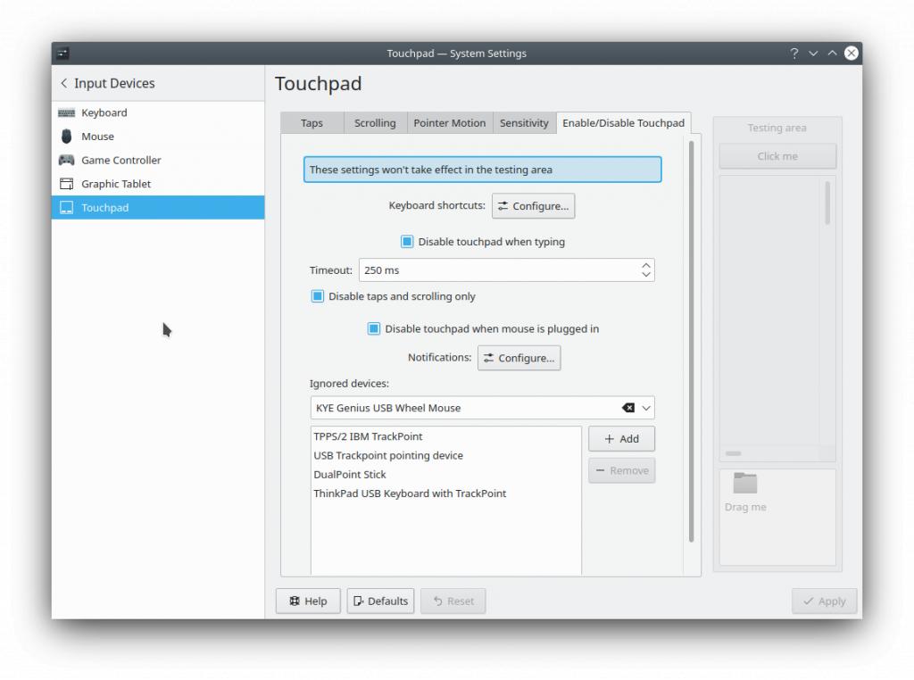

            System Settings > Hardware > Touchpad > Enable/Disable Touchpad and ensure that Disable touchpad when mouse is plugged in is checked.

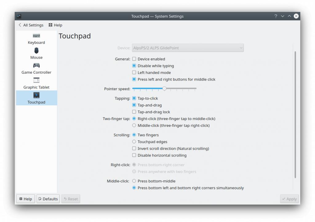

                  Here is a screen capture of my Touchpad panel
                    From your image, it appears that the vertical scroll bar indicates that there is 'more' below the last entry shown?
                      My settings widow.
                            True. What is not shown is the radio button "Press bottom left and bottom right" to simulate a middle click.
                            What you have is what I USED to have.
                              What Global Theme (System Settings > Global Theme) are you using? Of the default three available, I'm using Kubuntu. Different Themes can present (or hide) some options.
