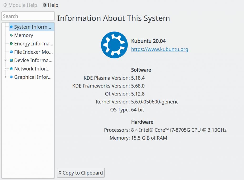

    I had the same problem and I decided to replace my version of Kubuntu 19.10 with the latest download of 20.04. So on my Laptop I have two similar versions of Kubuntu 20.04 in separate partitions.
    I found it interesting that this new installation did not result in the above reported error, even after installing the majority of packages.
    I had an alternative reason for wanting to have another copy of 20.04 in a separate partition. I was wanting to try the Linux Kernel 5.6 and didn't want to damage my "standard" version of 20.04.
    The approach that I have had success at installing Linux Kernel 5.6 can be found at http://ubuntuhandbook.org/index.php/...tu-linux-mint/.

    All is working well and I will certainly let you know if I have any problems as Kernel 5.6 has had a good report from phoronix at: https://www.phoronix.com/scan.php?pa...features&num=1

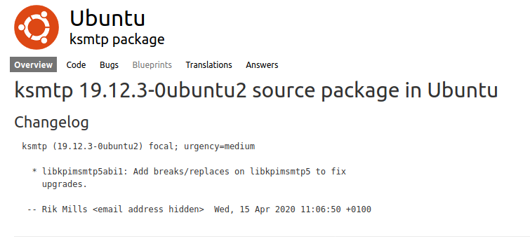

      Well, I didn't feel like going back to my snapshot, so I was finally able to purge KMail via Muon... It would error through Discover and even through Terminal when trying to purge.
      I did try to reinstall KMail afterward, but ran into the same error again, so I just purged it and ran the same commands you listed after a reboot. The error is gone when running updates. I never used KMail anyway, so not a big deal for me personally.
      While attempting to upgrade 236 packages I had a similar error:

      So, after wasting 30 minutes trying to resolve the issue it just took 3 minutes to roll back to the snapshot I made before the update, which I am running in right now.
        https://launchpad.net/ubuntu/+source....12.3-0ubuntu2

          So, you are telling us that the problem with libkpimsmtp5abi1 has been fixed? If so, how long with it take to arrive in the repository?
          EDIT: Did the update. All is well in the garden!

                  Besides fixing the libsmtp5bai1 problem, the update also repaired the mailto functionality on my FF75 browser.
