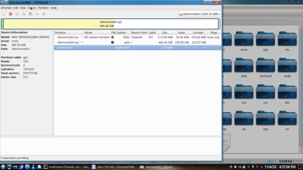

    Seriously, I should've done this right from the get-go, but didn't because of blah blah blah. So now I'm going to wipe my new laptop and partition its drive the way I normally do. But first I have a question.
    System76 shipped it with Ubuntu 20.04 installed; I installed Kubuntu on it...after a hopelessly borked first attempt. They have a fat32 partition, which I left untouched, but now want to get rid of. This screenshot of gParted shows my disk:
    I've never seen a drive formatted like this. I want my normal partition structure, i.e.:
    / -- the OS goes here
    /data -- media files and pretty much everything else go here
    /home -- self-explanatory
    [swap] -- which I don't think I need any more? Will I be given an option to use a swap *file* when I reinstall the OS?
    The fact that the fat32 partition has the word 'boot' in it scares me!
    Please advise ASAP, as I really want to get this done.
    The fat32 partition is what the label says it is. It is the EFI boot partition. This is where Grub boot files go to play, when the files are installed in a UEFI firmware environment. It is not scary, and in fact works very well. Here's what my filesystem layout looks like:

    The /boot/efi partition is - formally - an ESP. It is fat32 (vfat), with boot flags, on purpose as that is a universally recognized filesystem that the UEFI firmware recognizes during boot and then reads to find the actual boot files for whatever OS your system boots into. The rest is (for me) ext4 and includes separate / (/dev/sda2) and /home (/dev/sdb1) partitions. I also have another called /home/extra (/dev/sda3), just because I can and my /dev/sda (120GB) is much larger than what I need for the OS and SWAP.

      You can wipe it, the installer will create a new one, or gripe if there isn't one. This is necessary on modern systems, as it is using EFI for booting as opposed to the old mbr/bios.
      Wipe it, and create a new one of the same size, to get rid of the previous installs boot info, though a new install of the same OS will overwrite the files in the existing one EFI partition. (*buntu is *buntu in this arena)
      You can make it smaller, say 100mb would still be more than enough unless you want to multi-boot
        Okay, thanks guys. So it's safe to wipe it, and format the whole disk as I usually do, ext4.

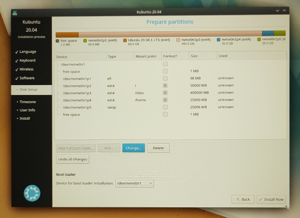

              Does this look okay? I could not delete or use the two 1MB free spaces, but that's trivial:

              ETA: it's cranking away...
                Leave the boot loader setting alone, the default setting is good, you would only change that if you had an efi dir on a different device. That setting option is a relic from the old days, and is not very clear.
                Swap can be smaller if you like, unless you enable hibernation. In that case, you need a touch more than your total ram size. But nothing wrong leaving everything as is
