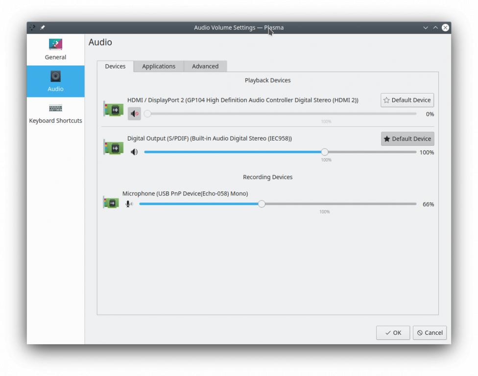

    Hello,
    Earlier this month my motherboard died. My computer build at the time was almost 10 years old so decided to buy new parts; I now have i7 10700k on a MSI MAG z790 Tomahawk. I also bought a 1TB m.2 drive for my linux install
    The problem is that after installing Kubuntu, the speakers stopped working. I see a "Dummy Device". I found a sticky on this forum where someone mentioned that a kernel update broke a lot of sound devices. Running the version of Kubuntu live from USB doesn't break the audio device. The kernel version on that is 5.4.0-26-generic. My current kernel version is 5.11.0-27-generic. I think that during installation it downloaded the recent update of the kernel.
    My knowledge of kernel isn't that advanced yet. Wondering if it's possible to revert the kernel version back or is there an easier fix?
    Thanks

      The thing is my speaker doesn't get detected at all unless I use 5.4. Is there a way to boot into 5.4 automatically instead of 5.11 without deleting any of the kernels?
      I still don't know why my speakers don't work in 5.11.0.27-generic, what should I look into fix this?
        When you say "speaker" are you actually referring to your audio chip? You can plug different kinds of speakers into the audio out jack on the side of your computer.
        You can determine IF your audio chip is being recognizes by looking for the "multimeida" section in the "sudo lshw" output. Mine shows:

            These are the devices I'm seeing in Audio Volume Settings:
            The DisplayPort 2 is just a monitor that's connected to my graphics card and doesn't have any speakers. Whenever I play video I notice the Digital Output bar animating indicating that sound is being played but I can't hear it; my speakers are turned on and the volume dial is up. As another test, I tried running kubuntu from USB and everything worked fine, I can play hear audio through my speakers.

              Decided to try and plug the speaker cable to the headphone jack at the front of my PC. I can now hear audio again! PulseAudio detected it as headphones being plugged in. Ideally I would prefer to have the connection be at the back motherboard ports so that the cable is out of the way. However this will have to suffice for now until I can find a fix. I'm guessing that there's some incompatibility somewhere with regards to my motherboard's audio input connections.
                Instead of using digital stereo, try switching to analog stereo (configuration). I remember having that problem once and that's how I fixed it.
                  Tried that but it says unplugged and unavailable
