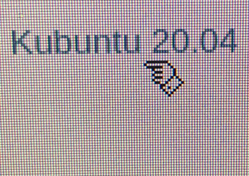

    Chromium is using a different set of cursors than other applications I have checked. They look like they came from MacOS from the early 90s.
    I have seen this posted a bunch of times in different forums including this one and nothing seems to work. I have rebooted my system about ten times in the last two days - I have done every version of "turn it off and turn it back on again" I can think of.
    I have read that this may be a problem with GTK application-appearance setting but can't find any such setting in Kubuntu. And it only happens in Chromium and only since I did a fresh from scratch re-install of 20.04. After I did the upgrade from 18.04 I had no such problems.
    What can I do to force Chromium to respect my system settings?
    [sorry for the huge image - had to use my iphone]

    I can't reproduce this on my system. Using the stock Breeze settings
    Note that CHromium is a snap, so it does use its own themes, but the default theme set included with this snap does include the breeze-gtk theme, and is supposed to include the correct cursors for breeze-gtk
    I am going to suspect that the required snap gtk-common-themes was manually uninstalled or did not get installed as a dep of Chromium for some reason. This is not normal, as the theme set is a core dep for either Chromium snap itself, or of the gnome libraries snap it needs.
    I discovered I can get Chromium to show this incorrect finger cursor if I uninstall the gtk-common-themes snap, so try installing that and see if it fixes the problem:
    $ snap list
    will show what components you have installed, use that to see if gtk-common-themes is in the list. If not, then install it:
    snap install gtk-common-themes
    If you have installed a custom cursor set for Plasma, then you may be sol
    Now to get rid of all the faff and fuzz I just installed
      Thanks Claydoh, that solved my problem!
