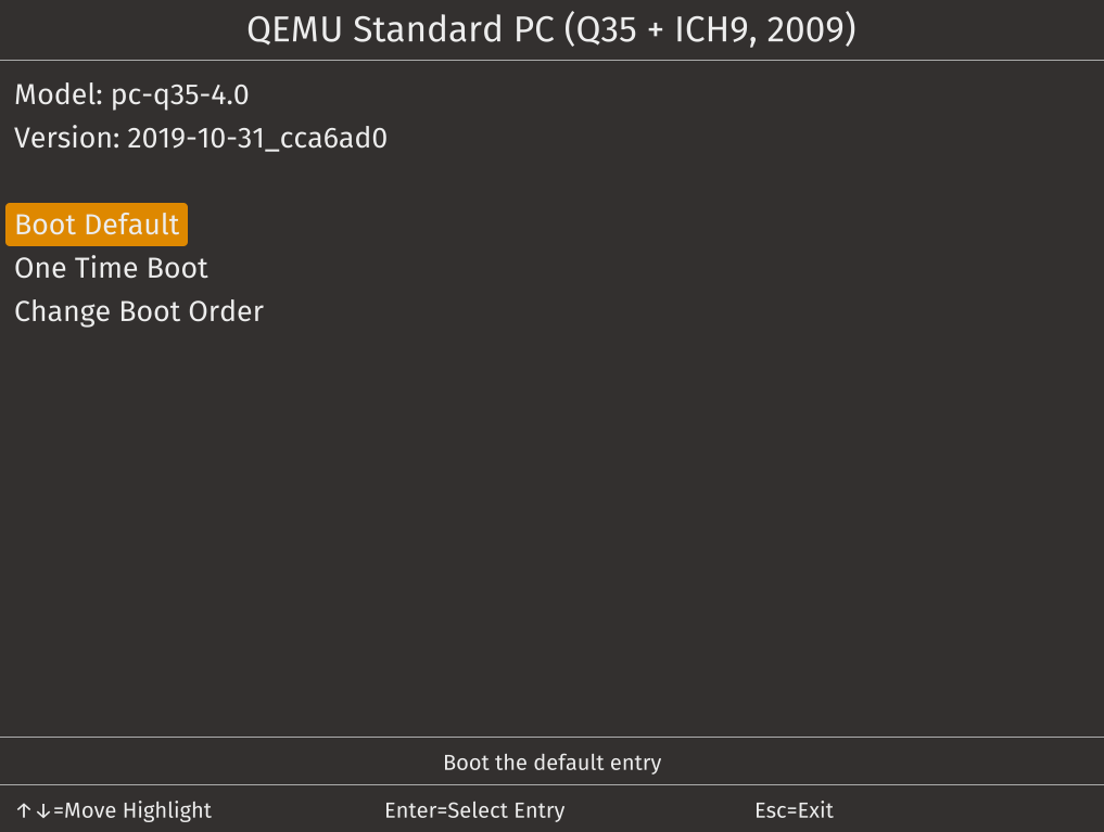

        I didn't see that post your linked to about System76 and when I looked at it this time and checked out your links and what they imply I was stunned.
        The Boot Default screen:
        What stunned me was the phrase "QEMU Standard PC ..."
        In trying to determine what that meant I found this in WIkipedia
        System emulation
        In this mode QEMU emulates a full computer system, including peripherals. It can be used to provide virtual hosting of several virtual computers on a single computer. QEMU can boot many guest operating systems, including Linux, Solaris, Microsoft Windows, DOS, and BSD;[6] it supports emulating several instruction sets, including x86, MIPS, 32-bit ARMv7, ARMv8, PowerPC, SPARC, ETRAX CRIS and MicroBlaze.
        I learned something new today: this is just one of the many powers that QEMU has, besides acting as hardware for the KVM.
        Now I am wondering if it is possible to install another ISO onto a System76 laptop and overwrite or bypass Quick EMUlation? I doubt it.
        The System76 BIOS doesn't give many options and what I've learned in researching this makes me question choosing a laptop from System76.
