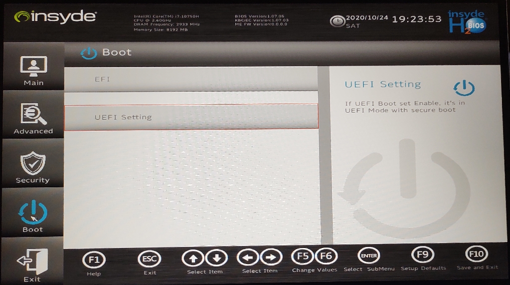

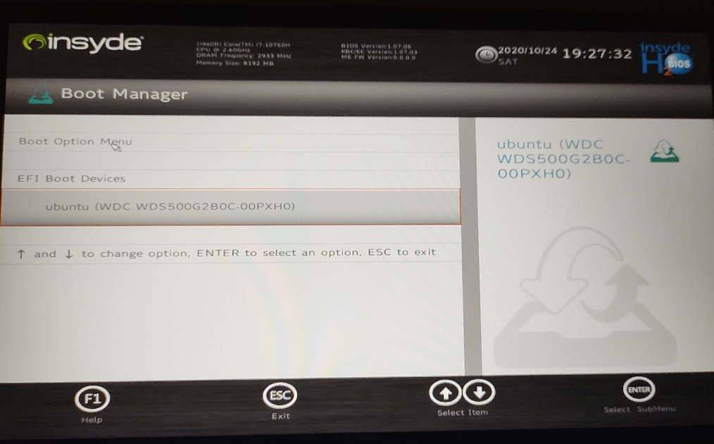

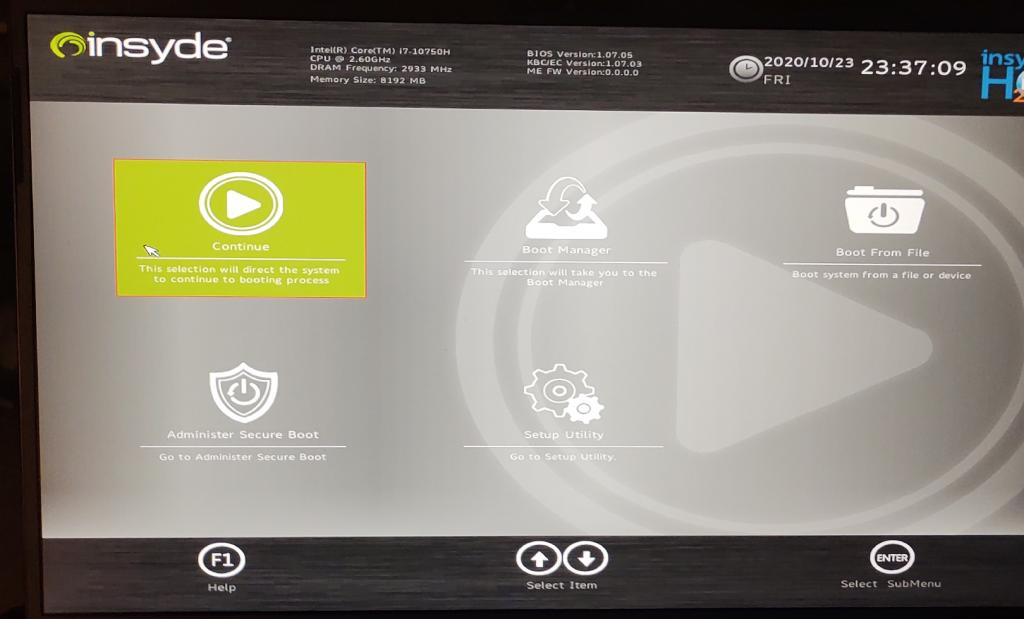

                      I'm not getting anywhere. I've attached a USB hard drive and it's recognized, but I'm either not seeing, or don't have, an option to boot from a USB device.
                      I've used 'recovery mode' and repaired broken files, and it grabbed and installed tons of files, ending with 'a reboot is required,' which I do...and then it doesn't. Back to square one.

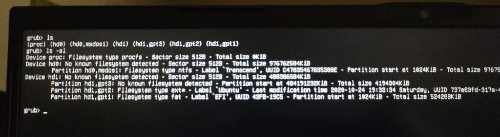

                      Here are some screenshots; in the various menus, I'm NOT finding a choice to boot from USB. You can see from the CLI that it's recognizing the external drive, Transcend.

                      So my question is...WTF?! I'm truly at a loss as to how things could get this screwed up just by installing Kubuntu. I remember a desktop I had about 15 years ago, and I used it to play with different DEs. I had KDE, GNOME, IceWM, XFCE and some other long-forgotten ones, all running side-by-side on that ancient box. I certainly didn't expect THIS to be a problem. What can I do to fix it? From a GRUB prompt? Otherwise?
                        How did you create the bootable installer? You still have to 'burn' the iso to the usb drive, using dd, Etcher, or k/ubuntu's included usb creator.
                          On another laptop, I downloaded the raw CD image from Kubuntu, saving it in the root directory of the external drive.
                          What can I do from a GRUB prompt to get back in business? Its list of commands, displayed by pressing [tab], is very short.
