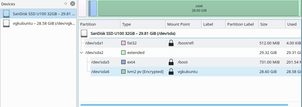

    I have installed the latest version of Kubuntu (20.04 LTS) on my laptop which has 30 GB SSD drive. I chose guided partitioning with encryption and everything went fine. When the system finished installing and rebooted, I checked the disk in GParted which reports that there are EFI and BIOS boot partitions both along with ext4 and swap partitions. I am providing screenshots below.
    Why did the system create EFI boot partition on top of BIOS boot partition even though I have a legacy system with DOS partition table?
    Did the system encrypt the whole drive (including swap)? Check the provided screenshots, please.
    File manager shows 4 partitions (check the last screenshot). Why?
    My main concern is if I have a fully encrypted drive or not?

    As can be seen in those two screenshots the "vgkubuntu" partition, which holds your root (/) and swap (sub-)partitions, is encrypted...
    I never used encryption yet so i can't comment on the rest...
    Well thats all for now, 3M
      The /boot partition is not a "BIOS" boot partition, since your disk is partitioned with a legacy (msdos) partition table. The /boot partition is used because in an lvm install the kernels reside out side the lvm containers, so a separate boot partition is created. This is choice made by ubuntu but not strictly necessary.
      The fat32 being created is a bug. It is not needed:
      https://www.kubuntuforums.net/showth...t32-partitions
