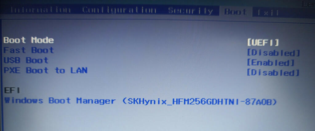

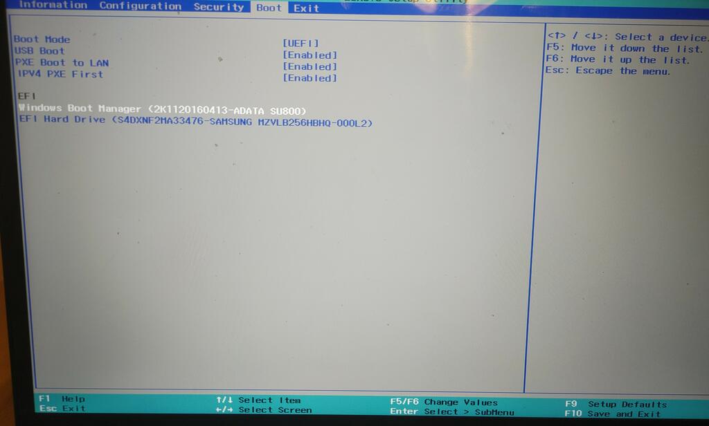

              So, it seems my Lenovo Flex15iiL just had a new bios update released this past week.
              And guess what? It reset some settings, such as the boot order selection....go figure
              It also reset my Fn-keys to use the secondary functions (volume, etc) as the primary action. This I am used to from past updates on multiple Lenovo laptops.
              Note that the Windows boot option is obvious, while the Linux one is not, in my case at least. Easily fixed by moving the other boot loader entry to the top.
              F2 during starup should get you to the settings, and f12 should get you a one-time boot selection to choose which OS boot loader to use.
              Now, see if you have similar settings - I will wager that we have very similar Bios menus considering the brand and similar age/hardware generation

                the BIOS update run from Microsuxs screwed mine. Click image for larger version
                  Odd af, to be sure
