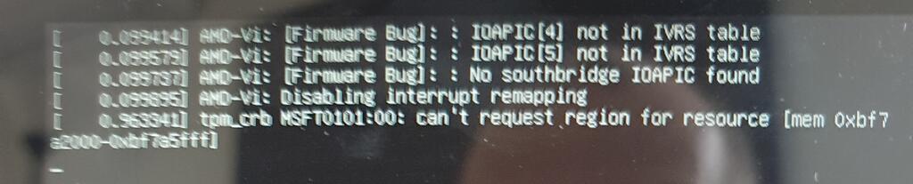

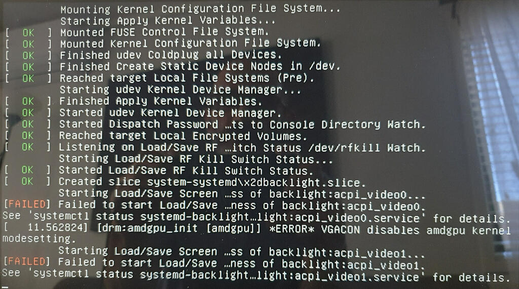

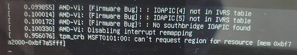

    Hello, this will be a clumsy post. As an end user, I am clumsy with commands, so apologies in advance.
    My OS is on a micro SD card with a full install (named phonic-otg) and has been working like a charm on my laptop until the botched update (I also have a live USB with persistence for troubleshooting).
    With the last update from Discover for the kernel and images etc associated with the title kernel (5.4.0-94) there was some sort of hiccup. After it downloaded them it started to install and got halfway through installing the first one then just hanged for about an hour, I rebooted and used discover again with the same result. I decided to reboot and use Konsole to do the update/upgrade, all seemed well until the next morning.
    I got a blank screen after the startup splash screen and no login. Rebooted to use the kernel recovery in grub, a few times trying fsck and dpkg also with no luck so started networking in recovery and dropped into the root cli and started a GUI with startx to use Konsole to try fsck which said I need to unmount first. So I used my live USB to do fsck on the USB with the issue (fsck -tf /dev/sdb5) restarted and then tried to use the phonic-otg USB with success, it gave me my login, and I was able to use things as normal. I thought the issue was solved but no, the same issue returned the next morning (today) I tried to startx from the TTY, but it didn't work. One of the dpkg errors said E Sub-process /usr/bin/dpkg returned an error 1. So I used my phone to search the issue and got many commands to try. I took photos of some and tried the script command to save the command's output from the TTY session and root recovery with weird results that show the command but the output recorded is gobbledegook. The main issue seems to be with a dpkg error.
    I have attached the output files and photo screenshots, also I can't attach any log files, so I saved them as a txt file.
    EDIT: not all attachment posted, so I will put them in a reply post.

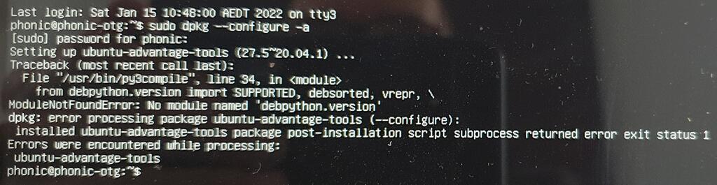

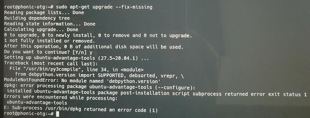

        I have done those early on. The attached photos show it.
        I did them again today, here is the result.
        root@phonic-otg:~# sudo dpkg --configure -a
        Setting up ubuntu-advantage-tools (27.5~20.04.1) ...
        Traceback (most recent call last):
        File "/usr/bin/py3compile", line 34, in <module>
        from debpython.version import SUPPORTED, debsorted, vrepr, \
        ModuleNotFoundError: No module named 'debpython.version'
        dpkg: error processing package ubuntu-advantage-tools (--configure):
        installed ubuntu-advantage-tools package post-installation script subprocess returned error exit status 1
        Errors were encountered while processing:
        root@phonic-otg:~# sudo apt -fix-missing install
        E: Command line option 'i' [from -fix-missing] is not understood in combination with the other options.
        root@phonic-otg:~#

                    Need to get 10.5 MB of archives.
                    After this operation, 0 B of additional disk space will be used.
                    Get:1 http://au.archive.ubuntu.com/ubuntu focal-updates/main amd64 linux-image-5.4.0-94-generic amd64 5.
                    4.0-94.106 [10.5 MB]
                    Fetched 10.5 MB in 6s (1,755 kB/s)
                    dpkg:warning: files list file for package 'ubuntu-advantage-tools' missing; assuming package has no fil
                    es currently installed
                    (Reading database ... 345559 files and directories currently installed.)
                    Preparing to unpack .../linux-image-5.4.0-94-generic_5.4.0-94.106_amd64.deb ...
                    Unpacking linux-image-5.4.0-94-generic (5.4.0-94.106) over (5.4.0-94.106) ...
                    Setting up linux-image-5.4.0-94-generic (5.4.0-94.106) ...
                    Processing triggers for linux-image-5.4.0-94-generic (5.4.0-94.106) ...
                    /etc/kernel/postinst.d/initramfs-tools:
                    update-initramfs: Generating /boot/initrd.img-5.4.0-94-generic
                    /etc/kernel/postinst.d/zz-update-grub:
                    Sourcing file `/etc/default/grub'
                    Sourcing file `/etc/default/grub.d/init-select.cfg'
                    Generating grub configuration file ...
                    Found linux image: /boot/vmlinuz-5.4.0-94-generic
                    Found initrd image: /boot/initrd.img-5.4.0-94-generic
                    Found linux image: /boot/vmlinuz-5.4.0-92-generic
                    Found initrd image: /boot/initrd.img-5.4.0-92-generic
                    Found linux image: /boot/vmlinuz-5.4.0-91-generic
                    Found initrd image: /boot/initrd.img-5.4.0-91-generic
                    Found linux image: /boot/vmlinuz-5.4.0-90-generic
                    Found initrd image: /boot/initrd.img-5.4.0-90-generic
                    Found linux image: /boot/vmlinuz-5.4.0-89-generic
                    Found initrd image: /boot/initrd.img-5.4.0-89-generic
                    Found memtest86+ image: /boot/memtest86+.elf
                    Found memtest86+ image: /boot/memtest86+.bin
                    done
                    root@phonic-otg:~# update-grub
                    done

                      Booting to login, went further with messaging and a hung cursor. Click image for larger version  Name:	retry-boot.jpg Views:	0 Size:	32.1 KB ID:	659881
                      There are similar Fail errors photo in post 8 of this thread.
                      Could the firmware for AMD be corrupted?
                      I am managing to run the root GUI from the Micro-SD card, so I don't think the card is corrupted yet.
                      EDIT: Searching about the firmware-bug led me to some pages that offered some insight.
                      On this page near the end, they say
                      I've also noticed that the offending param seems to be ivrs_ioapic[5]=00:02.0. In fact, if I boot the system only with ivrs_ioapic[4]=00:14.0 the firmware bug message disappears and the desktop boots as expected.
                      On this page, they suggest editing the GRUB_CMDLINE_LINUX_DEFAULT with various amd_iommu dump and flushes.
                      Here are some outputs of error journals and my system info.
                      root@phonic-otg:~# dmesg --level=err
                      [ 0.133564] AMD-Vi: [Firmware Bug]: : IOAPIC[4] not in IVRS table
                      [ 0.133737] AMD-Vi: [Firmware Bug]: : IOAPIC[5] not in IVRS table
                      [ 0.133903] AMD-Vi: [Firmware Bug]: : No southbridge IOAPIC found
                      [ 0.134068] AMD-Vi: Disabling interrupt remapping
                      [ 1.078347] tpm_crb MSFT0101:00: can't request region for resource [mem 0xbf7a2000-0xbf7a5fff]
                      [ 1.531146] [drm:amdgpu_init [amdgpu]] *ERROR* VGACON disables amdgpu kernel modesetting.
                      [ 3.041332] AMD-Vi: Event logged [IO_PAGE_FAULT device=00:00.0 domain=0x0000 address=0xfff123c0 flags=0x0050]
                      [ 3.041602] AMD-Vi: Event logged [IO_PAGE_FAULT device=00:00.0 domain=0x0000 address=0xfff123e0 flags=0x0050]
                      [ 3.041856] AMD-Vi: Event logged [IO_PAGE_FAULT device=00:00.0 domain=0x0000 address=0xfff12400 flags=0x0050]
                      [ 3.051375] AMD-Vi: Event logged [IO_PAGE_FAULT device=00:00.0 domain=0x0000 address=0xfff143c0 flags=0x0050]
                      [ 3.051631] AMD-Vi: Event logged [IO_PAGE_FAULT device=00:00.0 domain=0x0000 address=0xfff143e0 flags=0x0050]
                      [ 3.051890] AMD-Vi: Event logged [IO_PAGE_FAULT device=00:00.0 domain=0x0000 address=0xfff14400 flags=0x0050]
                      [ 3.061401] AMD-Vi: Event logged [IO_PAGE_FAULT device=00:00.0 domain=0x0000 address=0xfff143c0 flags=0x0050]
                      [ 3.061666] AMD-Vi: Event logged [IO_PAGE_FAULT device=00:00.0 domain=0x0000 address=0xfff143e0 flags=0x0050]
                      [ 3.061907] AMD-Vi: Event logged [IO_PAGE_FAULT device=00:00.0 domain=0x0000 address=0xfff14400 flags=0x0050]
                      [ 3.587445] sd 1:0:0:0: [sda] No Caching mode page found
                      [ 3.587616] sd 1:0:0:0: [sda] Assuming drive cache: write through
                      [ 12.607468] [drm:amdgpu_init [amdgpu]] *ERROR* VGACON disables amdgpu kernel modesetting.
                      [ 586.528337] rtw_pci 0000:01:00.0: failed to send h2c command
                      [ 1119.917415] rtw_pci 0000:01:00.0: failed to send h2c command

                          Woo-Hoo, everything seems to be restored!
                          Though, I am not sure what did it. It may have been the code, or it may have been the updates.
                          Both Info Centre and "uname -r" show the new kernel 5.4.0-96-generic to be operating.
                          I'll mark this as solved. Thanks to those who responded and kept me seeking out a solution.
                          Now when I upgrade my Lenovo M.2 SSD to 1TB and RAM from 8GB to 16GB I will use the Micro SD-card as an alternative back up storage. I may mess around with the 512GB SSD in an external case with a full distro of NEON.
                          EDIT: Almost had to remove "solved" and eat humble pie.
                          After 3 successful logins, I decided to turn on the pretty sddm login (installed via the inbuilt "Get More" when I first installed the OS to the MicroSD-card), I had reverted to the default login during this issue, and BAM the next reboot has the same issue as what created this thread, even startx from the TTY no longer worked again.
                          I thought if I could recreate the previous steps from post 12, first removing any login from settings with sddm.
                          I --reinstalled 5.4.0-96-generic, and did the sed attempt to write to grub and got an error, so I researched it and apparently the command is written wrong. Deciding to just manually edit /etc/default/grub with
                          GRUB_CMDLINE_LINUX_DEFAULT=".*[^"]/& amd_iommu_dump=1/g"
                          saved it and then
                          update-grub
                          on reboot I got a login screen again.
                          Very weird, it was the sddm login that re-broke the fix, as from kernel 5.4.0-26 to 5.4..0-92 there were no issues with it.
                            Sad to say, it looks like I am eating humble pie. None of the attempted fixes stick. I could really use some help.
                              Emphasis added.
                              It would seem to me that the 'pretty sddm login' you installed is the cause of the problem.
