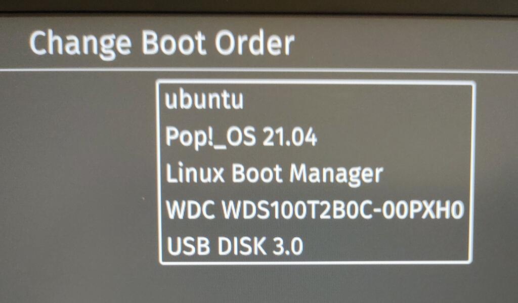

                    I'm back from making several more attempts. I was finally able to get in, sort of, by choosing 'safe graphics' at startup. Along the way I tried numerous things, including 'try Kubuntu' (from the live drive), but that just yielded a black screen with a text error message. I also tried installing K again, only this time using 'guided' and 'use entire disk' instead of my usual partitioning. Nope. Booting up still left me stranded at the S76 splash screen.
                    However, I think I'm on to something. Please look at these [awfully bad] pics:
                    As you can see from the first pic, it thinks Pop is installed.
                    But it's the second that I think may hold the key. Under "Boot loader" I don't think I've ever CHOSEN anything, i.e., whatever the default was, that's what I've always used. Looking at the partitions (this is its current arrangement), WHAT should I choose for boot loader? I had previously left it at the default--that obviously didn't work, so this time I chose the second entry, the one ending with p1. Nope. Before I waste any more time barking up the wrong tree, can someone just tell me which choice I should be using?

                      Perhaps the Pop OS option came from the NVRAM boot variables, and that the Kubuntu install failed to set them up properly, or that set up was messed with by a buggy UEFI.
                      I suggest running
                       sudo efibootmgr -v
                      Having booted from a USB you might have to apt install it first.
                      All those installs you did with the failing drive might have triggered a UEFI bug. These used to be common. On my desktop sometimes boot entries multiply and have to be cleared out.
                      Thanks, John. I posted my latest update before reading your reply--I'm done for today, but will give your suggestion a try tomorrow.
                        Those entries come from the NVRAM boot variables. The UEFI screens (often called the BIOS settings) should let you prune them, but those screens come from the motherboard, and vary between mobo manufacturers and models. However, on my desktop efibootmgr -v shows more detail, that can be checked. For example, my ubuntu entry shows as
                        Boot0000* ubuntu HD(1,GPT,ff254b9b-327c-4772-ad2f-8c789e4a69f8,0x800,0x100000)/File(\EFI\UBUNTU\GRUBX64.EFI)
                        The id, ff25...9f8, is the "partition UUID" of the EFI System Partition. Grub calls that partition "gpt1".
                        As I suggested, the entries of which you posted a picture explain why the laptop mentions Pop OS even though you've removed the drive with Pop OS on it. But it doesn't explain why the ubuntu entry doesn't work reliably.
                        I don't know what the Kubuntu installer is doing on the screenshot. In the BIOS/MBR days one could choose a partition for the bootloader, instead of the device, for some kludge to have multiple installs on the drive. I don't know what that means in a UEFI/GPT context. These days, I always run ubiquity with -b to tell it to not install a bootloader at all, I've already got one, thank you, under my control. (I edit grub.cfg manually like people used to with lolo's menu.lst. IME with multiple installs, grub always screws up sooner or later.)
