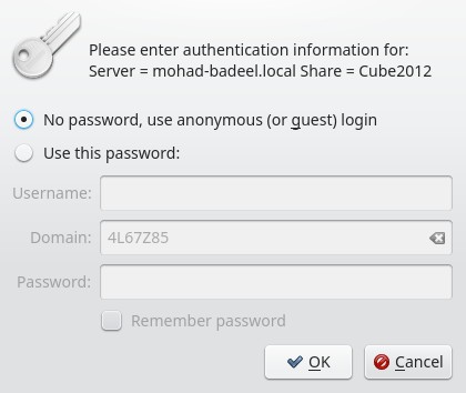

    Well, I am back again with more samba problems. I finally had it with my upstairs PC given me the "runs" and wiped and installed kubuntu 20.04 (from a corrupted version of 18.04) Still can't get Samba to work correctly. If I navigate to Network -> SMB -> ThisHostName -> I can see and get all the shares, BUT, it's listed as "smb://hostname.local/share" If I navigate to Network -> NETWORK -> ThisHostName -> I can see a two listings for ThisHostName. One is from an unknown source. The second is a picture of a folder with a global (globe) on it. It shows that it redirects to "smb://ThisHostName.local:445/" Networked Computer Whichever way I go, I now have a new login box, which goes no further. See Attachment

    Is there a more professional Samba support forum ? Is there a more modern guide. (sick to death of guides from the 1940's...) Sorry 2011 Besides the two Kubunto 20.04 talking to each other, I also need the following .Remote desktop. My knees are really starting to hurt .access to the shares from a windowsXP machine to index stored files on the drives. The Upstairs PC is mostly used as file storage and media playback for the kids. And I don't give a **** about security, so the picture shows my workgroup and hostname. Don't frigging care. If I don't get anywhere with this, I'm going back to 18.04. At least samba/remote desktop f***ing worked there without any problems. Nor do I care about edicate in this group. I've had enough of Samba not working since 20.04 upgrade

        Yes thanks. I've used that on one then both pcs, but besides 'root' being the only user on some shares, it doesn't help with what is going WRONG. I've managed to get the kubuntu shares to work, BUT with
        smb://mohad-badeel[b].local[/b]/share
        WindowsXP now sees the workgroup, and the kubuntu PCs, but will NOT log in to them. I am slowly making my way through the smb.conf switches, but it is difficult What is it with the .local bit on the hostname. I cannot find any information out about it. This is even across the network. Is this some update with samba?
