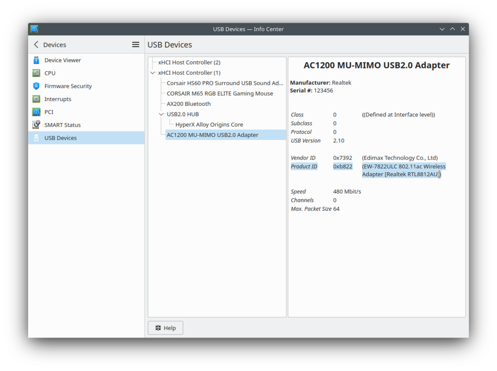

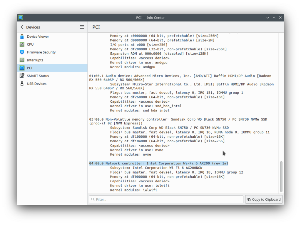

      A good guess is that the desktop PC's wifi card doesn't support 5Ghz
      if you don't know what type of card/chip it has, you can find some info using the Info Center tool.
ID:	667904 Click image for larger version
      Look for it under PCI devices, similar to the first image. You can use filters and use 'net' or similar strings to help wade through.
      If you have a USB dongle instead of in internal card, use the USB section, as seen on the right. In both cases you can copy the actual text into a reply.
