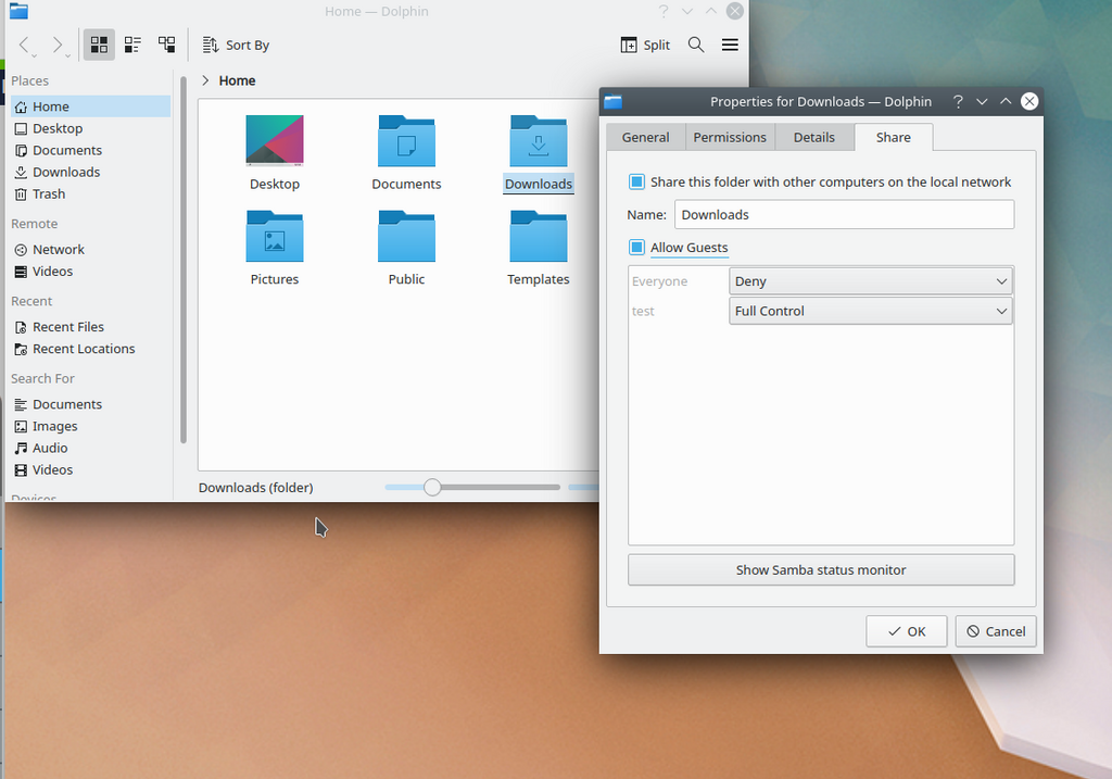

    I think you have to unintuitively Allow Guests, then adjust the settings
    Something like this?
    Click image for larger version  Name:	Screenshot_20221012_154751.png Views:	0 Size:	441.7 KB ID:	665889
    I may have then un-checked the Allow Guests button.
    In any case, in my test, the password did not work, but it definitely disabled open access
    SMB can be a pita, and the KDE sharing applet sometimes does not help.
