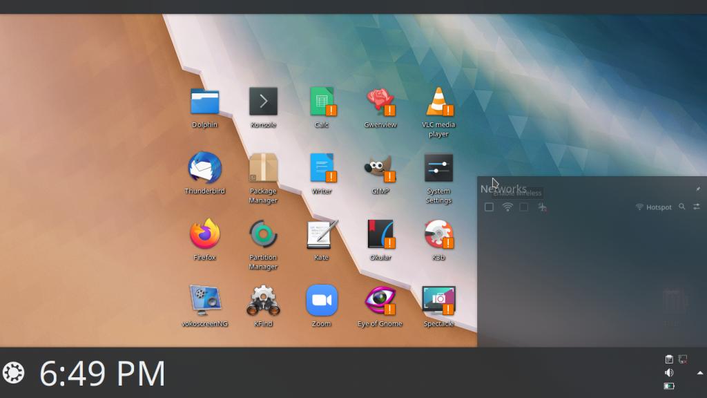

            But where do I go to turn it on ? When I 'hover' over the box at top left I get a label 'Enable Wireless' which would seem to be what you mean but 'clicking' on it does [/I]not [/I]make it fill in. The curved symbol next to it does nothing and the third box - which does fill in - switches on airline mode. I will try to attach a screen dump.

              BTW, what happens when you click on the empty box below the word "Networks" in your image?

                      Some themes make it look the opposite of what is expected so I made a screengrab for reference. Tho I should have used the default Kubuntu theme beforehand....

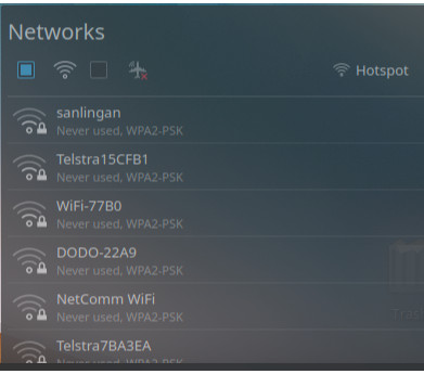

                        That did something but not what I was expecting. See attached screen dumps. That top left box did turn blue but the pop up list was a lengthy one of what seem like 'national' WiFis and none of the local ones - for example not my neighbour whom I know has one. I will take the laptop out to somewhere I know there are public WiFis and see what the list becomes.

                          Keith, those definitely are wifi IDs from local homes and establishments in your area. Often these names are just the defaults set by the device brand or provider. I see many with 'ATT' as it is a popular provider here, as well as 'xfinity', which is another one.
                          Move your laptop to a different spot, and you very likely will see the list change as wifi strength changes a LOT when it has to go through walls from both your neighbours' homes then though yours. You may well have to scroll though a long list in the widget to find the one you are looking for.

                          Clicking the box in the top left corner turns wifi off and on. Yours was not checked (blue color) as your wifi was physically disabled until the FN-F2 key combo re-enabled it.
