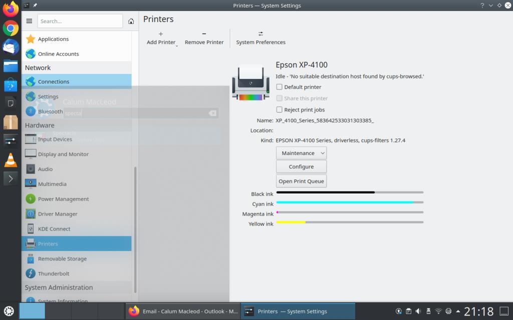

When the XP-4100 printer is plugged in the system installs it in the newfangled driverless fashion but the printer shows up under 'Discovered Network Printers' rather than 'Local Printers', which surely can't be right? [we checked this by clicking 'Add Printer' to see how it locates it].

Attached is a screenshot of what my brother sees in System Settings after the printer balks at the second print job.
