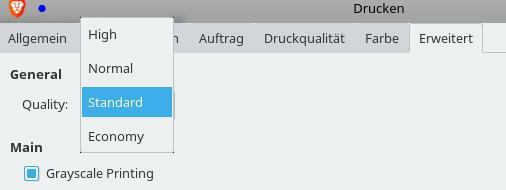

    i need a help from an expert. i have the Canon printer MAXIFY MB5455.
    I have install the Linux driver of Canon. i can print by USB and WLAN without problems.

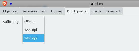

    But i can not choose on the print option page quality and other thing.
    i wanted to do that
    https://wiki.ubuntuusers.de//Archiv/...Druckertreiber
    but i do not know which ppd in which directory i have to edit.
    can someone help me please.

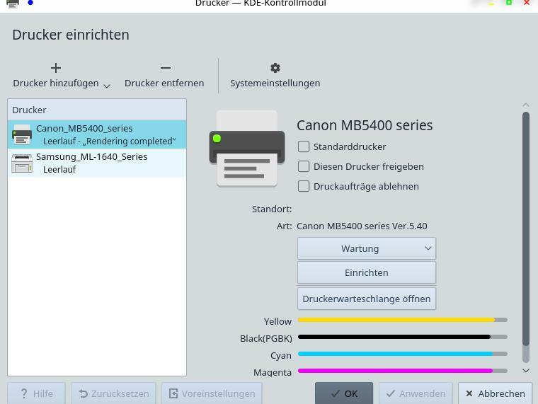

      What specifically did you download and install (Link?)
      Which driver/version is shown in the System Settings GUI?
      Have you looked to see if there are others to choose from (there sometimes are)

        which driver you can see in the attachment. it is only this driver.
        i have tried cups driver too. i can choos other quality but than the priter do not print.

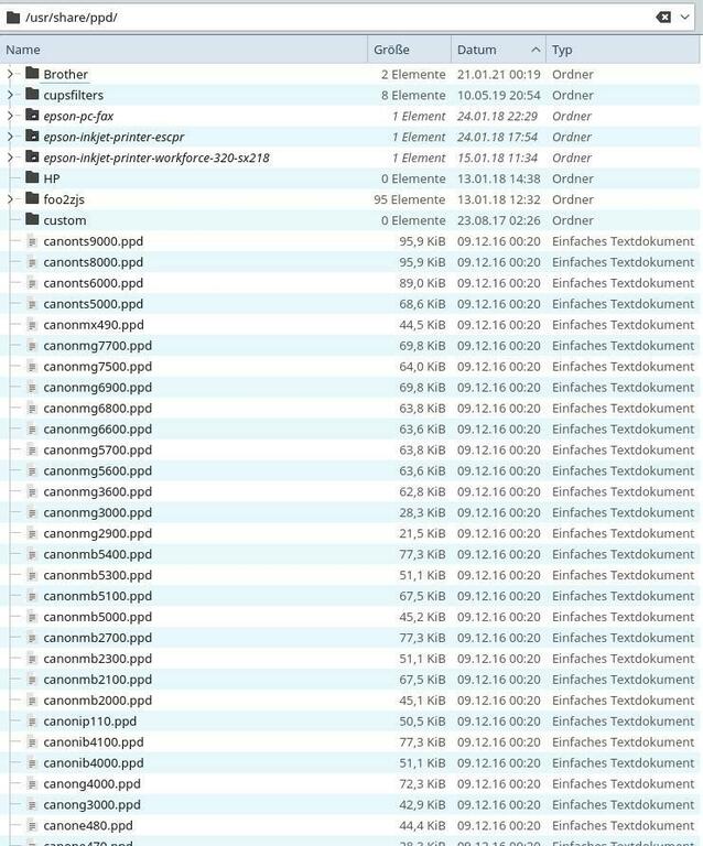

        the driver of
        /usr/share/ppd/
        are old of the year 2016. see attachment.

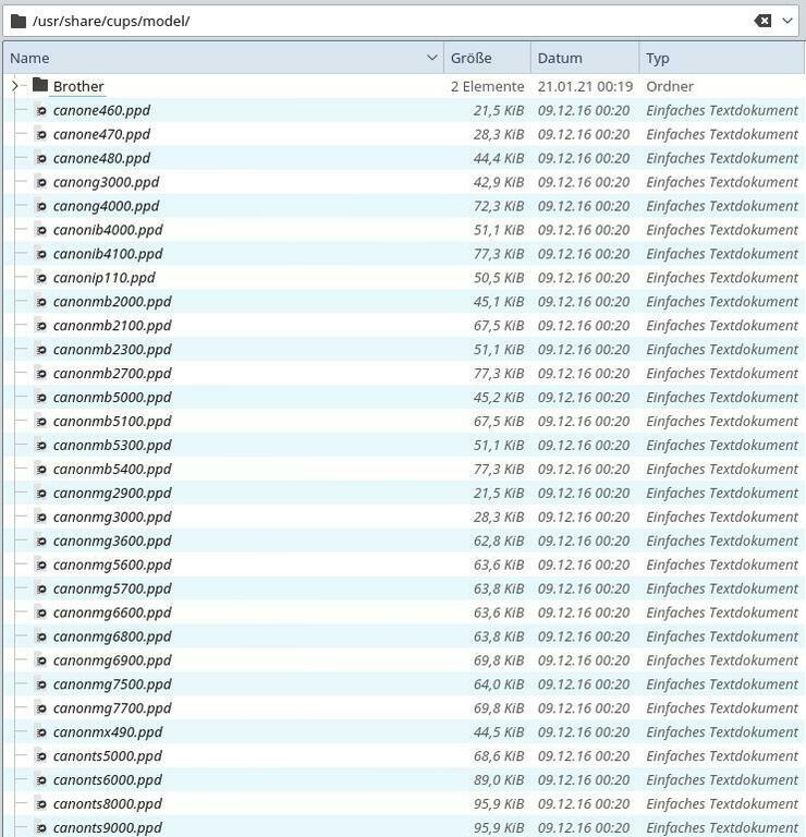

        the ppd of
        /usr/share/cups/model/​
        is also of the year 2016
        see attachment.

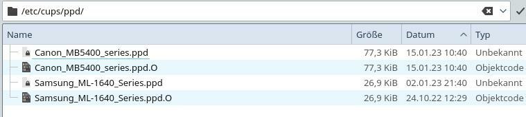

        the ppd of
        /etc/cups/ppd/​
        are very new see attachment.
        which ppd should i edit?
        should i open it with sudo kate /etc/cups/ppd/ ?
        normal i can open it.
        i am getting this error report
        The file file:///etc/cups/ppd/Canon_MB5400_series.ppd cannot be loaded because it is unreadable.
        Please check your access rights.

          I am going to guess that /etc/cups/ppd/​​ copies the file from /usr/share/ppd/
          /usr/share/cups/model/​ contains links, so is not useful here.
          The file in /etc/cups/ppd/​​​ is read-only, iirc so it can't be modified while in use.

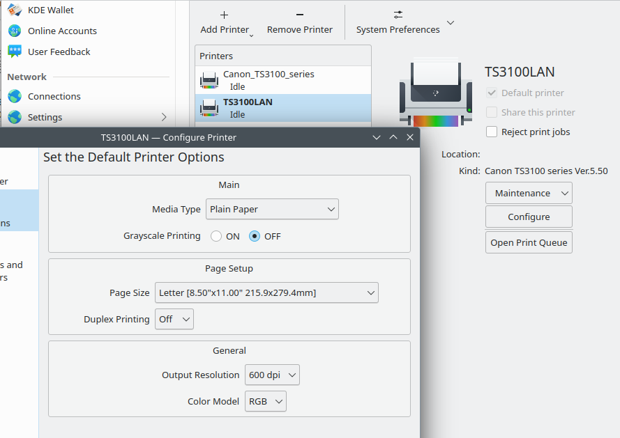

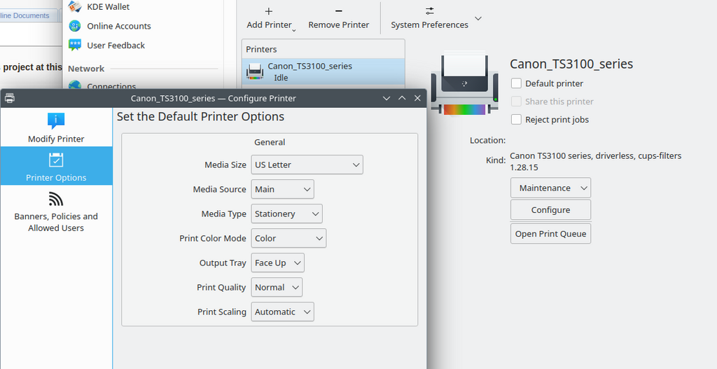

          I was playing around here, as I have a very cheap Canon Wifi printer that Just Works, and uses the very standard 'driverless' wifi printing standards.
          Here are the options I get
          I just now downloaded and installed the official drivers from Canon, basically the same thing you downloaded, though slightly newer.
          I get hardly any of the options I had before -- installing the Canon drivers on the cli set up this 'TS3100LAN' via prompts. Luckily, it has not removed my existing entry for the printer.

            i have opened in
            /usr/share/ppd/
            canonmb5400.ppd
            normal with kate without sudo
            i have edit it. after saviing i am getting this error.
            The document cannot be saved because writing to file:///usr/share/ppd/canonmb5400.ppd is not possible.
            Please check whether you have write permissions for the file and whether there is enough storage space.​
            should i open the file with sudo to save it?

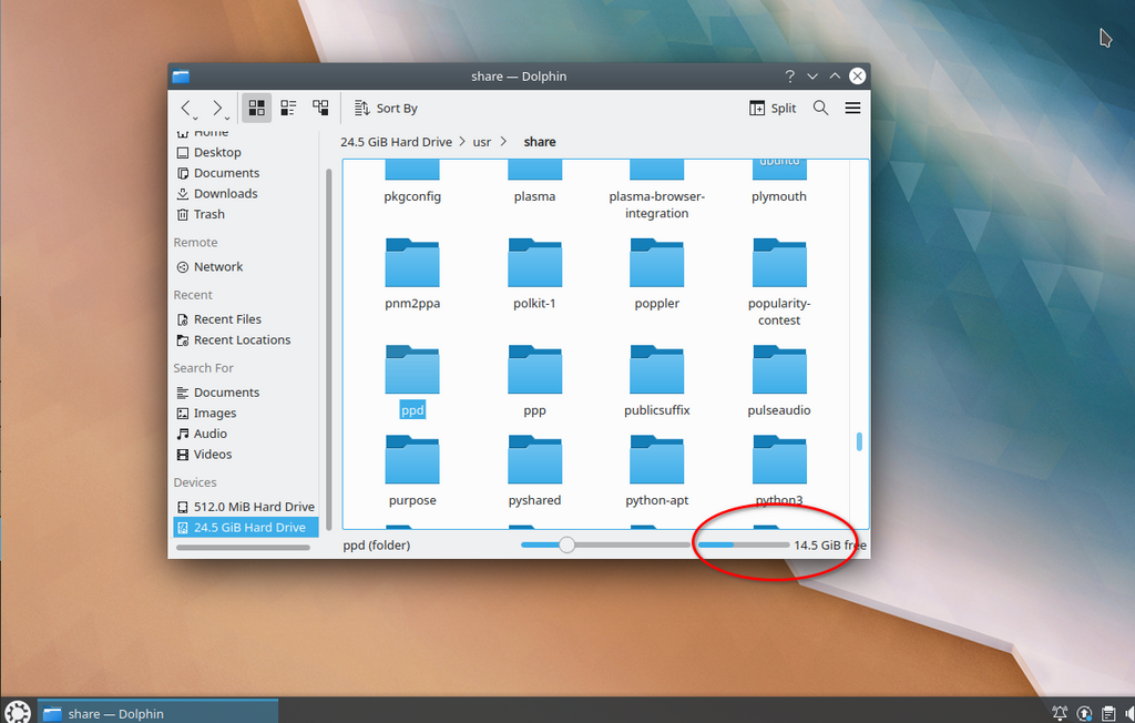

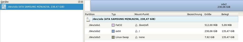

              That error messaging you see might be accurate -- is your root directory. your hard, drive full? There needs to be space for temp files an caches, etc. If your root is full, it can't do this.
              Look at Dolphin for clues:
              Or use df -h in the terminal for more precise info.
              For the moment, try to clear up some space, A quick and easy way is to do a quick cleanup of unused software packages:
              sudo apt autoremove
              and to clear apt's download cache
              sudo apt clean
              This should free enough space for you to try again, but this may need to be addressed later. Autoremove might be enough for now, if you note how much it removes. if it offered a LOT of old kernels, this should give give you a fair of wiggle room for a little while.

                here the result oof df-h
                salsero@HP:~$ df -h
                Dateisystem Größe Benutzt Verf. Verw% Eingehängt auf
                udev 3,9G 0 3,9G 0% /dev
                tmpfs 789M 85M 705M 11% /run
                /dev/sda2 227G 124G 91G 58% /
                tmpfs 3,9G 76M 3,8G 2% /dev/shm
                tmpfs 5,0M 4,0K 5,0M 1% /run/lock
                tmpfs 3,9G 0 3,9G 0% /sys/fs/cgroup
                /dev/sda1 511M 5,1M 506M 1% /boot/efi
                tmpfs 789M 48K 789M 1% /run/user/1000
                /dev/mapper/truecrypt2 9,4G 5,9G 3,1G 66% /media/truecrypt2
                /dev/mapper/truecrypt3 20G 16G 2,7G 86% /media/truecrypt3
                /dev/mapper/truecrypt4 4,4G 2,1G 2,4G 47% /media/truecrypt4
                /dev/loop22 50M 50M 0 100% /snap/snapd/17950
                normally my disk isnt full. see attachment.

                -rw-r--r-- 1 root root 22049 Dez 9 2016 canonmg2900.ppd
                -rw-r--r-- 1 root root 29026 Dez 9 2016 canonmg3000.ppd
                -rw-r--r-- 1 root root 64329 Dez 9 2016 canonmg3600.ppd
                -rw-r--r-- 1 root root 65113 Dez 9 2016 canonmg5600.ppd
                -rw-r--r-- 1 root root 65355 Dez 9 2016 canonmg5700.ppd
                -rw-r--r-- 1 root root 65087 Dez 9 2016 canonmg6600.ppd
                -rw-r--r-- 1 root root 65355 Dez 9 2016 canonmg6800.ppd
                -rw-r--r-- 1 root root 71457 Dez 9 2016 canonmg6900.ppd
                -rw-r--r-- 1 root root 65587 Dez 9 2016 canonmg7500.ppd
                -rw-r--r-- 1 root root 71457 Dez 9 2016 canonmg7700.ppd
                -rw-r--r-- 1 root root 45519 Dez 9 2016 canonmx490.ppd
                -rw-r--r-- 1 root root 70213 Dez 9 2016 canonts5000.ppd
                -rw-r--r-- 1 root root 91159 Dez 9 2016 canonts6000.ppd
                -rw-r--r-- 1 root root 98151 Dez 9 2016 canonts8000.ppd
                -rw-r--r-- 1 root root 98151 Dez 9 2016 canonts9000.ppd
                drwxr-xr-x 2 root root 4096 Mai 10 2019 cupsfilters
                drwxrwsr-t 2 root lpadmin 4096 Aug 23 2017 custom
                lrwxrwxrwx 1 root root 36 Jan 24 2018 epson-inkjet-printer-escpr -> /opt/epson-inkjet-printer-escpr/ppds
                lrwxrwxrwx 1 root root 50 Jan 15 2018 epson-inkjet-printer-workforce-320-sx218 -> /opt/epson-inkjet-printer-workforce-320-sx218/ppds
                lrwxrwxrwx 1 root root 22 Jan 24 2018 epson-pc-fax -> /opt/epson-pc-fax/ppds
                drwxr-xr-x 2 root root 4096 Jan 13 2018 foo2zjs
                drwxr-xr-x 2 root root 73728 Jan 13 2018 HP
                the folder /usr/share/ppd is with 90,9 GB free

                  Originally posted by sisqonrw View Post
                  nano canonmb5400.ppd
                  "[ Error writing canonmb5400.ppd: No permission ]"
                  For nano (or vim or micro …) you will have to use sudo :
                  sudo nano canonmb5400.ppd
                  Kate realizes if you need to have elevated permissions to write a file and asks you accordingly (normally).
                    ok i can choose
                    600, 1200, 2400 dpi
                    and quality normal, high, standard economy
                    but when i choose 1200 and high the printer print same speed and the simple quality.
                    and is there something that can i delete or is to much?

                      I *think* the ppd file being actively used is in /etc/cups/ppd, which i *think* is copied from /usr/share/ppd. This is why I suggested removing the printer from thje GUI, editing the file in /usr/share/ppd, and re-adding the printer, to force the desired settings to (hopefully) take effect.
                      If you can open both files in nano , make sure both have the same settings. You may need to restart CUPS for the change to take effect, too. Unplugging the USB might be enough, but I don't know.
                      Me, if yours is acting anything like my Canon, I'd just uninstall the canon drivers, delete the printer form the GUI, and go wireless and "driverless", since it seems to have more settings. Scanning works over wifi, too, using Skanlite/Xsane. I don't recall doing anything special to get that working, either.

                        i have done all this thinks before.
                        i can choose more thins than before. the attachmet.
                        but the printer print in the same speed and same quality when i am choosing 2400 or 1200 dpi

                            TS3122, seen as TS3100 series driver, as seen in my screenshots.
                            I use it over wifi
                            Maybe the driver for your model is just poorly made by Canon?
                            I have no more ideas, unfortunately.
                              As this is a brand new printer: have you tried to ask Canon support about a solution?
