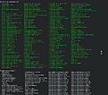

            Be aware of just how much of Gnome GDM pulls in, and not a fully complete Gnome, either:
            Plus the added services, etc. involved, and the common bugs and oddities this sort of thing is known to cause for many:
            Click image for larger version  Name:	Screenshot_20260718_201313.png Views:	0 Size:	629.8 KB ID:	693375
            Click image for larger version  Name:	Screenshot_20260718_201414.png Views:	0 Size:	34.2 KB ID:	693376​one
