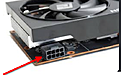

Yes all AMD graphic cards will work with your system.Originally posted by oldgeek View PostHmmm, a lot to think about. I have a further question. I have a laptop with AND processor and graphics card (7000) and have been running 25.10 without problems (haven't upgraded yet). But my desktop computer uses this CPU: 12 X Intel Core i5-10400 2.90 GHz, and I also have 16 Gb memory (no SSDs on this system). Would an AND graphics card be compatible with this setup? I live in Peru, so it may not be so easy to get one of these. Thanks again for all the help.
Examples:.Year GPU Display Output Version Power Draw 2017 AMD Radeon RX 550 HDMI 2.0b / DP 1.4 ~50W 2017 AMD Radeon RX 560 HDMI 2.0b / DP 1.4 ~75W 2022 AMD Radeon RX 6400 HDMI 2.1 / DP 1.4a ~53W 2022 AMD Radeon RX 6500 HDMI 2.1 / DP 1.4a ~107W 2021 AMD Radeon RX 6600 HDMI 2.1 / DP 1.4a ~132W 2023 AMD Radeon RX 7600 HDMI 2.1 / DP 2.1 ~165W
All low power variants are OK (up to 75W). Just plug them in.
The gaming variants do sometimes need more power (100W+).
You should check if you can power it. If it has one of these POWER connectors on the side then you might need to upgrade your Power supply.
They come in 6pin or 8pin. Some have dual 8pin connectors.Last edited by INVICTRA; May 09, 2026, 03:30 PM.
