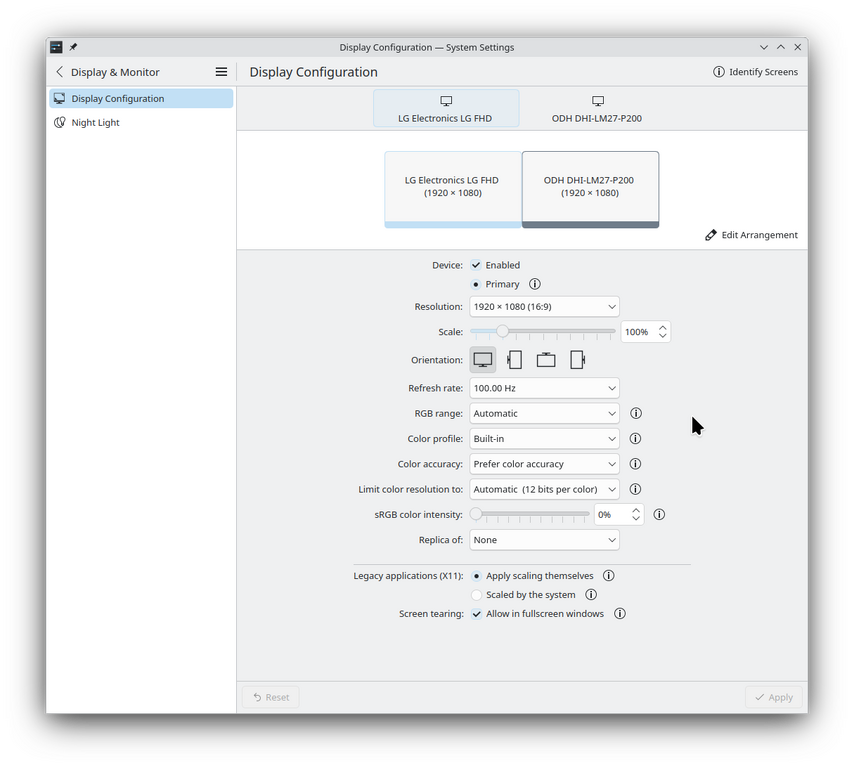

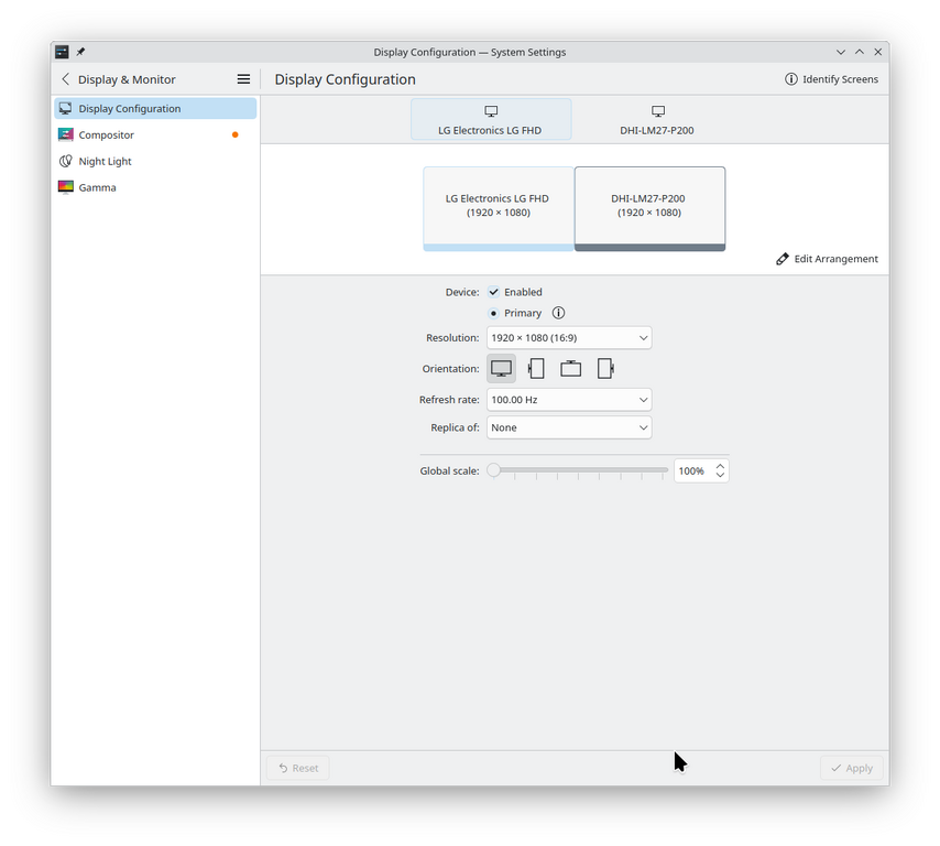

          For Plasma 6 configuration, it's all the same places as in Plasma 5. Just some different (fewer) options if you use X11, and your monitor's capabilities. Here are my mis-matched pair of dirt cheap 24 and 27" monitors in Plasma 6.4.4:
          Click image for larger version  Name:	Screenshot_20250905_013825.png Views:	0 Size:	137.9 KB ID:	688308​Click image for larger version  Name:	Screenshot_20250905_014624.png Views:	0 Size:	92.5 KB ID:	688309​
          Switching between x11 and wayland can cause some settings to change between them, such as window placements at login, but overall there shouldn't be any dramas. Are there any specific things you need to look at?
          If you test out Wayland in Plasma 5, you might see things even weirder when swapping between them -- such as completely different configurations and even labels, as if you had two different sets of monitors. I *think* that was remedied well before Plasma 5.27, but I can't recall for sure now lol, but if it looks like you lost all your monitor/panel settings when switching, this will be why.
