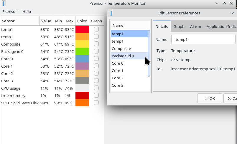

    Check a different sensor tool, psensor may be bugged, or needs configuration. Mine also reads 99C
    But :
    sudo smartctl -a /dev/sda
    shows it at a much more same 67, or is it 33? (the raw value is 33, the value is 67)) -- it is idle most of the time.
    Now, Psensor shows this temp (33) as temp1 for me, which is a drive temp, and composite is my NVME drive, so.......

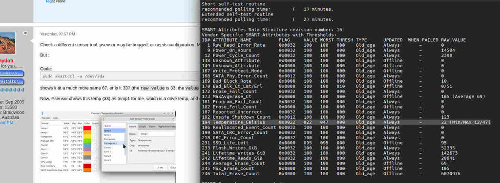

      Cheking with this command seem to be that the average temperature​ is 22 and the worst was 47
      This is the place where i have to look, right?​ Click image for larger version
