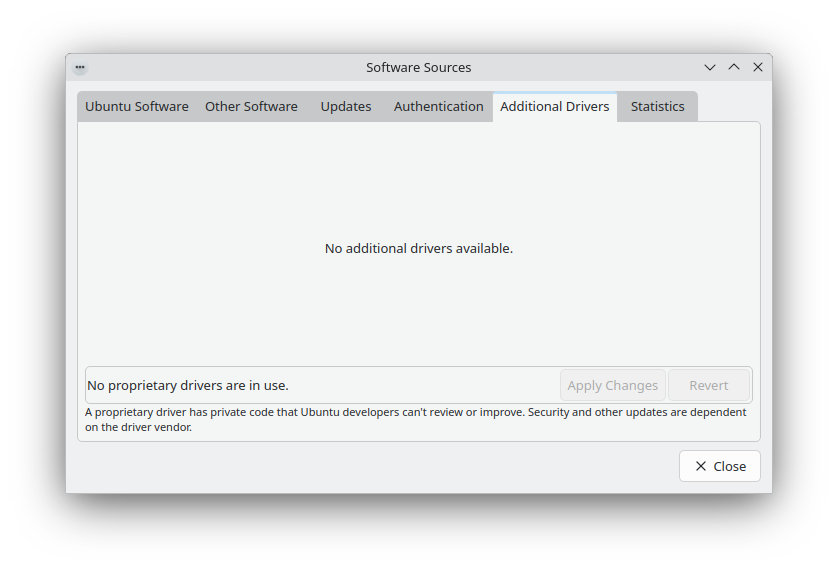

              I ran drivers in system settings, and after the search, it was empty!

              Now what?

                This is correct - since Intel graphic use the built-in kernel and mesa drivers, there are no 'additional drivers' to install. This is normal.
                I don't know where to begin troubleshooting why the driver modules are not loading or not working on Intel, to be honest.
