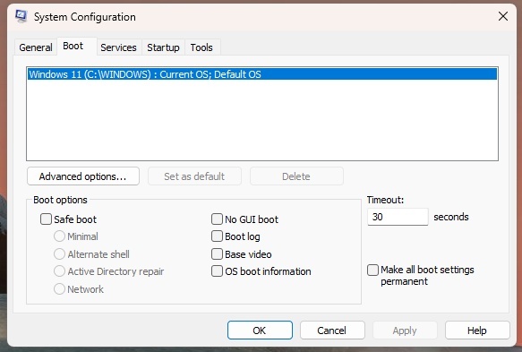

                  But this:
                  In summary: While Windows 11 doesn't directly change the BIOS boot order, certain events within the operating system can lead to unintentional alterations. You can always check and adjust the BIOS boot order through the BIOS setup utility. ​
                  Click image for larger version  Name:	win11-boot.jpg Views:	0 Size:	46.8 KB ID:	686240
                  Window pretends it doesn't see any bootable Linux partitions.
