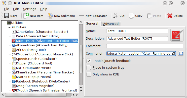

                  if it is something you often need you can add an item to your "K=menu" by right clicking on the icon, selecting Menu editor, just use use 'kdesudo kate' as the command and save the menu (again if you use root kate often),
                  personally i use askrieger method usually with the file i want to edit tacked at the end (i.e kdesudo kate /etc/X11/xorg.conf)

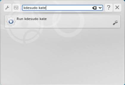

                        Be warned that if you are starting the graphical version of VIM with sudo then you might still cause yourself problems. The error messages you got were most likely caused by using sudo to start graphical applications. I don't think Kate is the problem. I will restate what everyone has already said, but much more plainly worded.
                        Never start GUI applications with sudo
                        As was already mentioned, if you really want to start Kate with superuser privileges then try using kdesudo from KRunner instead. There are many different ways to open KRunner, but among the easiest are:

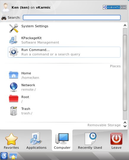

                        • KMenu -> Computer -> Run Command: See the first attached image
                        • Right click your desktop background and choose Run Command: See the second attached image
                        • Press and release the F2 key on your keyboard while holding down the Alt key: See the third attached image
                        After KRunner appears, just type in the name of the GUI application you want to start. To start the application as root (AKA with superuser privileges) preface the application name with kdesudo. See the fourth attached image for an example of using KRunner to start Kate with superuser privileges.
                        KDESudo will prompt you for your password. Enter the same password you use to login to Kubuntu.
