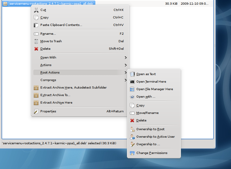

    Installing the appropriate Rog131 ppa deb from here for the context menu would probably be the easiest way to get those back. I personally wouldn't add his entire repo, since some other packages might get upgraded that you don't want to have changed... but you can decide that for yourself.
    https://launchpad.net/~samrog131/+archive/ppa
    servicemenu-rootactions 2.4.7.1~karmic~ppa1 Sam Rog (2009-11-04)
    https://launchpad.net/~samrog131/+ar...c~ppa1_all.deb
    Maybe if we say Rog131 a bunch of times he'll magically appear and confirm that this is what you want...
    Rog131 Rog131 Rog131 Rog131 Rog131 Rog131 Rog131 Rog131 Rog131 Rog131 Rog131 Rog131
    Or I suppose I can install it, which I just did... looks like what you want:

      Thanks for the reply. Looks like it would do what I want.
        Re: 'edit as root' missing from context menu
        This is the rootactions_servicemenu written by kubicle and conveniently packaged by Rog131. It is an outstanding addition to Dolphin or Konqueror.

                  To restore the "Open As Root" option under the "Actions" context menu (worked for me):
                  Paste the following code into a text file, and name it "OpenAsRoot.desktop" (or whatever):
                  [Desktop Action OpenAsRoot]
                  Exec=kdesu dolphin %U
                  Icon=folder-red
                  Name=Open as Root
                  [Desktop Entry]
                  Actions=OpenAsRoot
                  Icon=folder-red
                  ServiceTypes=KonqPopupMenu/Plugin,inode/directory,inode/directory-locked
                  Type=Service
                  Save the file to:
                   ~/.kde/share/kde4/services
                  Then close and re-open Dolphin, and you should have "Open As Root" as an option under "Actions" in the context menu.
