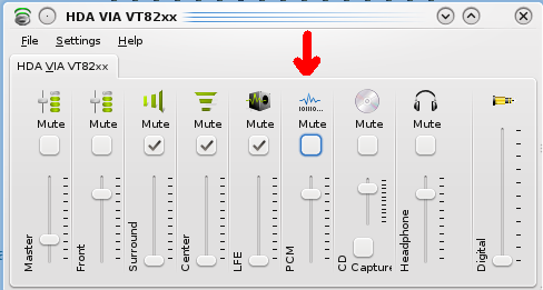

              That sounds unfamiliar to me... Could you pleas check in Kmix: Settings>>Configure Channels and see whether the PCM channel is enabled?
              What does it look like if you don't have a slider? Just to check whether we are looking at the same thing, I uploaded a screenshot of my KMIX (PCM channel indicated by red arrow).
              If your lay-out only shows tick boxes and not sliders, I am very curious what it looks like?
