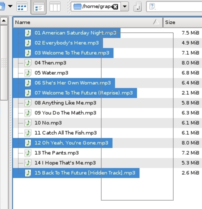

              This might be off-topic, but since I already talked a bit about it, I figured I would add this to the discussion to see if this should be considered a bug or not.
              When doing click-drag selecting, the order of highlighting [or selecting] is stored/remembered when the selected files are opened together.
              As an example, I took the contents of a CD with good variable name lengths and did a left click at the bottom right of the konqueror window in the white space, and the dragged the mouse straight up to the top, and then moved right to left to select all the files. they were highlighted/selected as soon as the mouse box hit the first filename character in each file.
              the click-drag image show this progression - first only a few are selected, then a bit more files get selected as the mouse moves left, and then more, etc. At the end I highlighted them all and then right-clicked to open them in kaffeine, and then captured the playlist order.
              the playlist order resembles the file selection order, and is essentially ordered by name length.
              The question at hand then seems to be whether this would be considered a bug or a feature of some sort.
