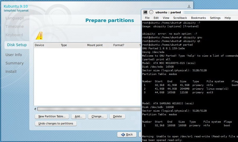

    Under installation (from live CD or from desktop under booted kubuntu live CD) the disk setup step does not seem the hard drives. All previous (k)ubuntu and other distro can install without problem, Just 9.10!
    The system seem the HDD-s (command line parted, and konqueror). Nothing changes made on hardware...
    See the screenshot:

      I try this nothing... In BIOS, 3 choiche: disabled , compatible, enhanced. default is enhanced, but i try both mode.
      Any other idea?
      Why working perfectly ALL other program with HDD-s? And under working 9.10 (liveCD) system, why not work the installer?

            Just look's like... but not same.
            Here's all program seem all drives all partitions, except installer...

                I do it, and all disks all partition is corret.
                9.02 and above is work correctly! Just the 9.10 not. What's the different in installer?
