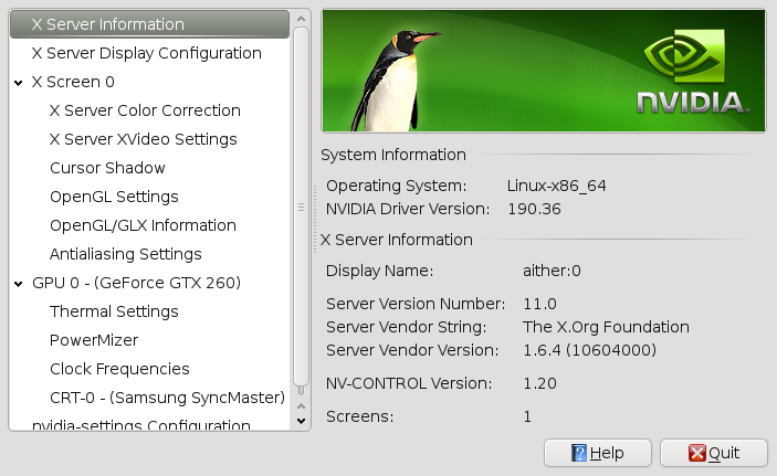

                          The 190.36 Beta driver is running fine on my 9.10 system -- I can't find any fault with it.

                            Ok, I got the 190.32 package installed (That was the latest that they had on the site) and so far all is well.
                            Did you install the 32bit compat drivers that it offered?
                            Thanks!!!
                            Joe
                              Re: update yesterday == no boot today?
                              Says 190.36 here: http://www.nvnews.net/vbulletin/showthread.php?t=122606
                              Right?
                              YES, I choose "yes" on the 32-bit compatibility. After I've got a good working xorg.conf, I choose "no" to have it overwrite it on a subsequent driver installation.
