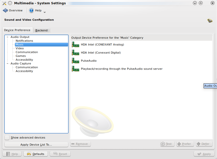

        Re: 9.10 no sound on hp dv6 1201au
        What does System Settings > Multimedia > Sound and Video Configuration > Music show?
          there are 3 items:
          HDA ATI SB (stac 92xx Analog)
          pulseaudio
          HDA ATI HDMA (ATI HDMA) (hdma audio output)
          on the test none of them works..
                      ok, I got a message that some audiodevices were removed at the start but didn't have any options.at the multimedia tab there is a new option
                      Playback/recording thru audiopluse sound server
                        Test each one.
                          none of them works
