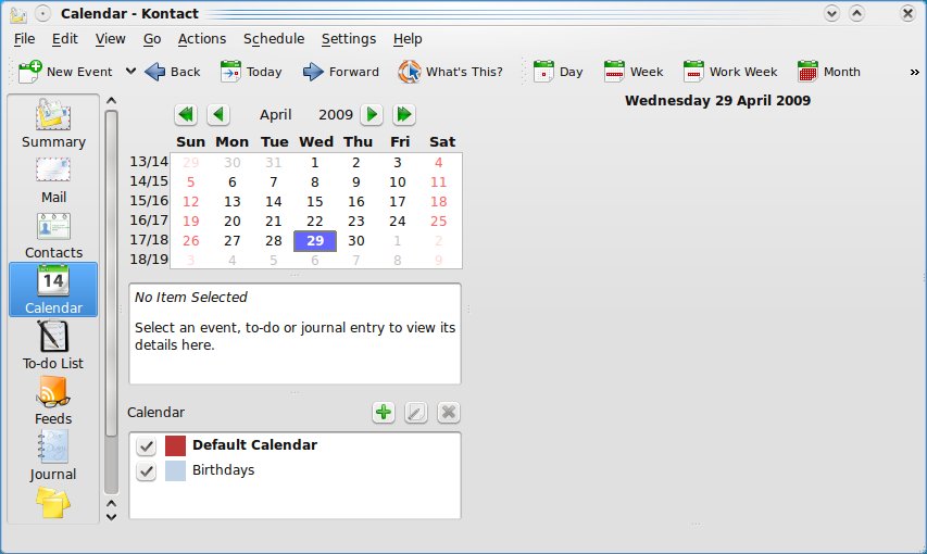

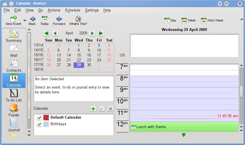

      Please see three attached screenshots:
      DayView - in Kubuntu, Calendar display in single day mode, entire day display is missing;
      DayViewSUSE - in openSUSE, Calendar display in single day mode, day and appointment are shown as expected.

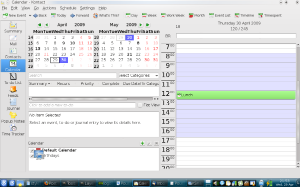

        My problem is that I have a very slow line and it is difficult to upload even small things. But I will try again.
        To attach the picture, I used the attach file funtion here in the forum. Click on Additional Options under the editor and choose your file.
        Otherwise, upload your picture somewhere and link to it here by clicking on the picture icon in the second row of buttons (second button from the left). Insert the link to the actual picture between the tags that appear (not a link to the page).
        As you can see in the attached picture, I do not have the problem that you have with the calendar. My installation is Kubuntu 9.04 that has been upgraded since alpha 6. I will check with a friend if his version that was installed from the release version is different. I believe they should be the same.
