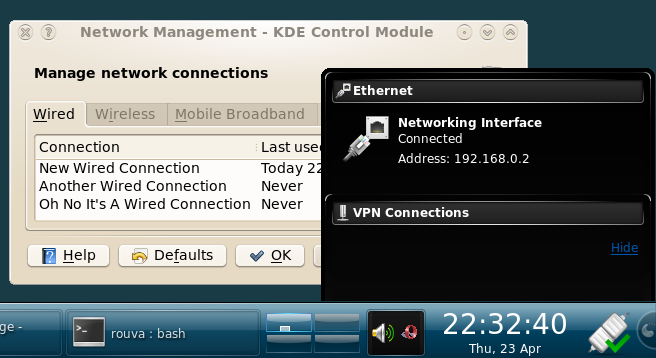

        Just tried to play with it and plasma/panel/something crashed and came back. (And again just now.) Now it's not showing the two extra wired networks I set up, just the automatic one. (It just crashed again.) So, uh. I don't know. What happened to using ifup/ifdown anyway?
        Edit: Ah, the new connections had somehow "broken off" and were floating in their own black, plasmoid boxes on the desktop. X-ed those and they're back "integrated", if superimposed over the VPN category...
        ...now they're gone again. I don't even know how to tell which connection is active. It should be "New Wired Connection".
        Edit: And it keeps crashing -- like when I click "OK" on the Settings or Manage Connections dialogs.
        Well, knetworkmanager still exists, too.

          ifupdown still works as long as you get rid of network-manager. There is also a GUI tool called wicd which is great for wireless. It works well.
          sudo aptitude install wicd
          will get it for you.

                In network-manager the applet and the non-applet are quite connected, especially for wireless. The non-applet part will start a wired network at boot, but will not start a wireless interface until it finds an applet. That in my opinion is the best reason not to use it.
                It is not really either or. ifupdown is used to configure lo so you do not want to uninstall it.
                /etc/NetworkManager/nm-system-settings.conf contains a setting to tell network-manager to not manage an interface that is listed in /etc/network/interfaces. This defaults to true, but somehow network manager seems to manage them anyway and cause confusion.
                I don't think you can use network-manager to bring an interface down. If you down it with
                sudo ifconfig eth0 down
                network-manager will try to bring it back up.
                I am becoming more and more convinced that network-manager is of no use to me what so ever. For ethernet connections they can be configure very easily and reliably with ifupdown and do not need to have daemons running in the background, using up resources and confusing my process tree. For wireless connections, at home I want it to come up before I login so I can ssh to the machine and network-manager just will not do that. Especially with the flakiness of the KDE applet, wicd is just a much better solution. It gives me good reliable control of my network, and makes wireless easy.
