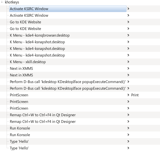

I have a lot of duplicates in khotkeys. One of them is print and no matter how I go about reassigning it, I may get it to work for a session but it is never persistent. maybe, having so many duplicates may have something to do with it? I tried getting rid of the configuration for it *but* that doesn't solve the problem. How do I reset it and/or how do I get it back into a working and a persistent state?

No matter what I try to do to that file inside KDE or outside with KDM stopped, those duplicates will forever stay there. I searched google upside down for resetting/restoring them and I must be an idiot. Those hot keys just aren't going anywhere
I never realized how many times I use the print key until this :/
PS. I made an attachment. What in the world do I have to do to fix this?

I finally fixed it. I couldn't do it while in KDE so this is what I did. I logged out of KDE and pressed Ctrl+Alt+F1 to get to a terminal. I then ran these commands.
Code:sudo /etc/init.d/kdm stop cp ~/.kde/share/config/kglobalshortcutsrc ~/.kde/share/config/kglobalshortcutsrc__backup mv ~/.kde/share/config/khotkeysrc ~/.kde/share/config/khotkeysrc__backup vim ~/.kde/share/config/kglobalshortcutsrc # At this point, I simply removed [khotkeys] and all of its directives, saved and exit sudo /etc/init.d/kdm start
