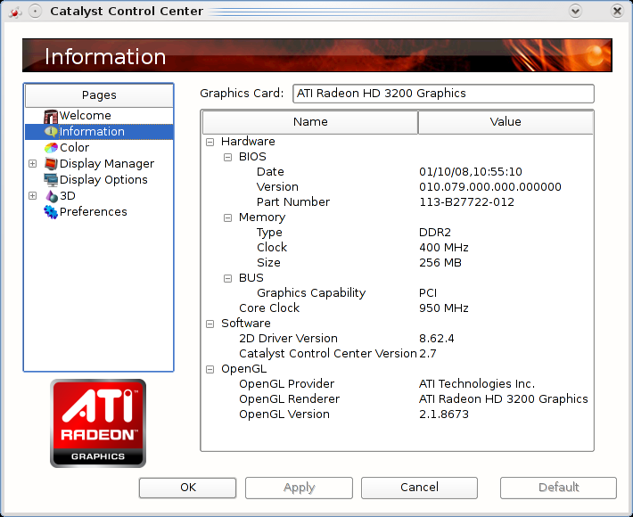

                            Mmmm, do you have dkms installed? It is the responsible to build things for the current kernel (you also need the kernel headers)
                            This is how things should look (you _do_ know will get this working soon )
