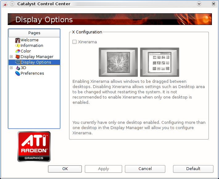

            Alright, I reinstalled Kubuntu, and this time completely skipped over the proprietary drivers installer that pops up, opting instead for just the driver off ATI's website (version 9.6). Now I don't have catalyst at all, and seem to have to way to get it. But Kubuntu's dialog is still just the same.
            [img width=400 height=235]http://darkfirelabs.net/randomstuff/snapshot1.png[/img]
            As you can see, I have all the options, except the ones I need, the vertical and horizontal offset.
            Any ideas?

                So, what do you see in amdcccle ?
                  Re: Problem getting dual displays running on HD 4870
                  Like I said, I don't have Catalyst Control Center installed, and I can't find a download for it on ATI's website. When I pull up the page for my card all I have is the driver.
